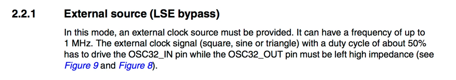

I was reading today an ST document about hardware design and I got into this:
What about using a MEMS oscillator like this
http://www.abracon.com/Oscillators/ASTMKJ.pdf
to get rid of the crystal circuit tuning mess? Did anyone tried this approach?
henry.dick
Mar 14, 2018 4:09 PM UTC
Posted on March 14, 2018 at 16:09
I have used some mems oscillators - and found them to be nothing special vs. the regular crystal. they do consume considerably less energy than the regulator oscillators.
I think they are useful in two areas:
1. low power consumption - obviously;
2. tough environment where you are concerned about a crystal not getting to oscillation.
I don't think there is much to gain here by going to an external oscillator, including a mems oscillator.
