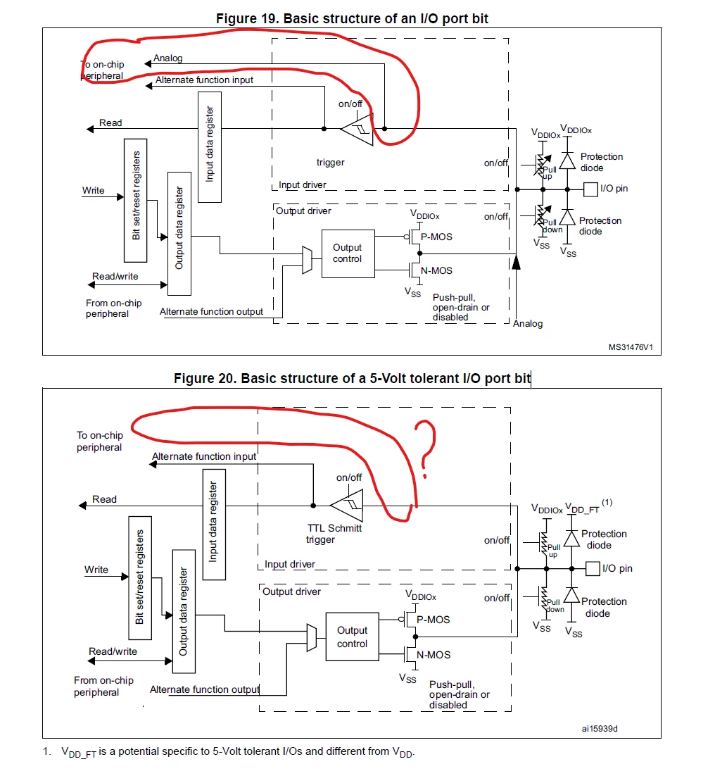

Hello everyone,
I have a question about 5V tolerant I/O in analog mode. When I look Figure 20. Basic structure of a 5-Volt tolerant I/O port bit in RM0377, i don't see the analog arrow as in figure 19.
Is it an error on figure or 5V tolerant I/O doesn't work in analog mode ?
Thanks for any response

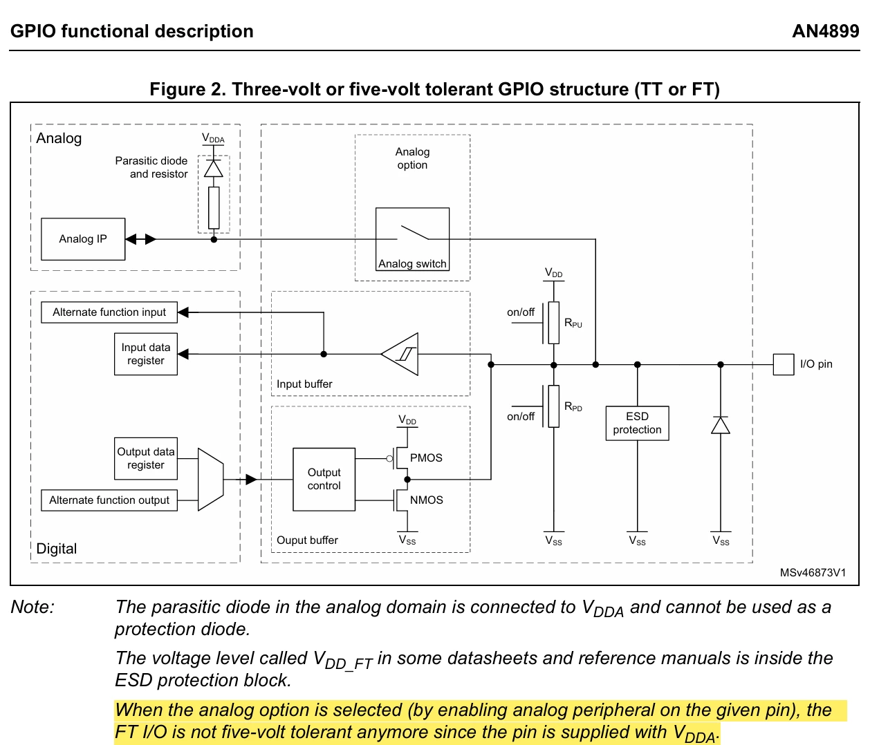

Somewhere there is a note that pins in analog mode are not 5V tolerant. I will try to find it.
Edit: Can only find this:
And this, which says the analog switch is only closed when the ADC is activated. The pin will still be 5V tolerant if the ADC is inactive.
Solved: Are STM32L0 FT pins 5V tolerant in Analog mode whe... - STMicroelectronics Community
February 18, 2025
I see this note, but my question is : Do 5V Tolerant work in analog mode ? Because I don't see a link to analog mode in figure 20
February 18, 2025
No, they are not 5V tolerant when in analog mode and being used by the ADC.

February 18, 2025
Its just : only as digital input a pin can (FT_ pins) tolerate 0...5V signal.
As soon as you use any other pin setting, output or analog, ist always limited to vss-vdd (or vdda), 0...3v3 typical.
The ADC itself anyway working on vssa - vdda , so nothing else possible as ADC-input.
