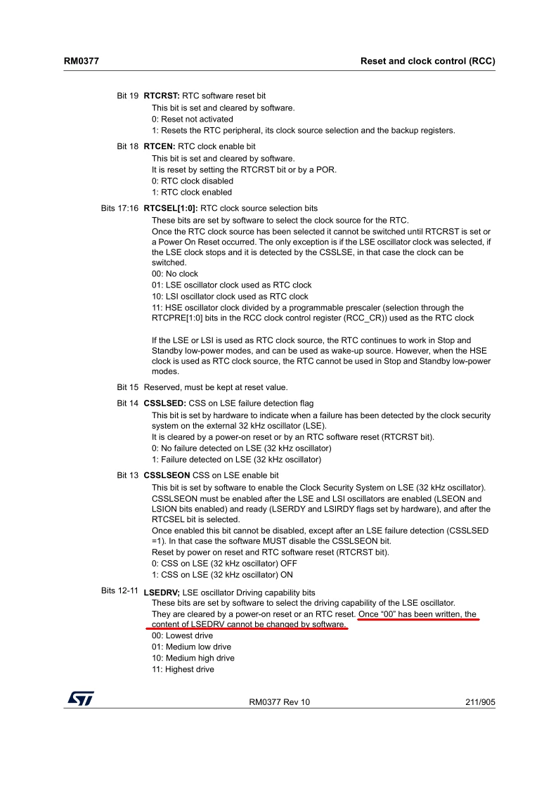

STM32L031 - LSEDRV "lock" does not work
0693W00000LveVWQAZ.pngI've just tried on an 'L031 - after writing LSEDRV to 0b00 (using debugger), I can rewrite it freely to any other value, and the oscillator's behaviour follows the value written.
Can ST please comment.

Please check the link. It is done here!

Hi Bouraoui,
Thanks!
Jan
