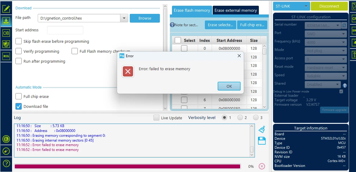

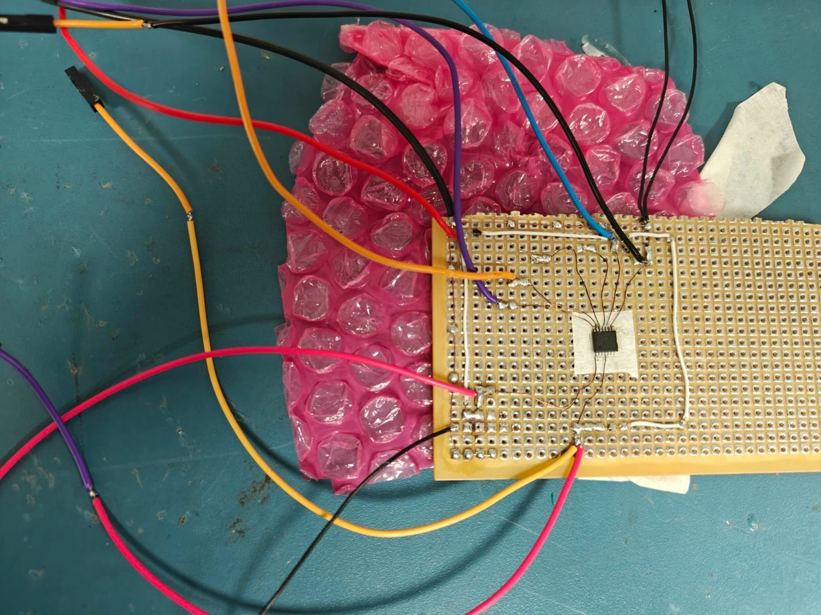

I have taken one dot board  a placed the MCU (TSSOP14) STM32L021D4P7 wired with STLINK V2 programmer , Boot0 pin to pull up and pull down option with jumper wire , NRST pin also same pull up 10kohm and jumper wire to pull down to ground. In STM32 CUBE programmer latest version i am using STM32CubeProgrammer 2.23.0 , chip is only detecting if under hot plug mode , under reset mode it not working , its first time from factory its programming through SWDIO /SWCLK VCC and VSS . After detecting the hex file if a loaded its showing internal memory [0 45] failed to erase, so RDP - i kept to AA it in STMcube programmer after that if i click file for programming in GUI its crashing the tool. Kindly give help to program this IC.

Is the board (?) design correct, with decoupling capacitors? Show this.

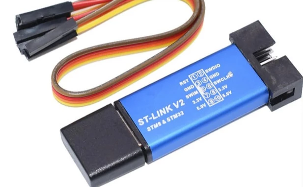

Are you using a legit programmer? Which one? “STLINK V2” is ambiguous.
How to recognize a genuine ST-LINK/V2 versus a cloned one | Community

  3. In hot plug mode this is detected , but not able to dump the hex file attached a error image
  4. first clarify we can use this blue color USB STLINK for this CHIP to program or white color is original one ?
  5.  I have tryed one more thing a RDP option byte was previously 0 so i changed to AA as no protection after updating that its not coming successfully. STM32 cube programmer GUI is crashing.

I would guess this is a failure of any decoupling capacitors. Your board layout is missing all of them.
Getting started with STM32L0xx hardware development
The blue programmer is a knock off programmer and may or may not work. The white one could be either fake or genuine. Did you read the link in my previous post?
Soldering to a bare chip seems odd. It would be better to solder the chip to the board where it will be used, then program it there.

Programmer you suggest a original one to buy most almost not to differentiate clone vs original.
