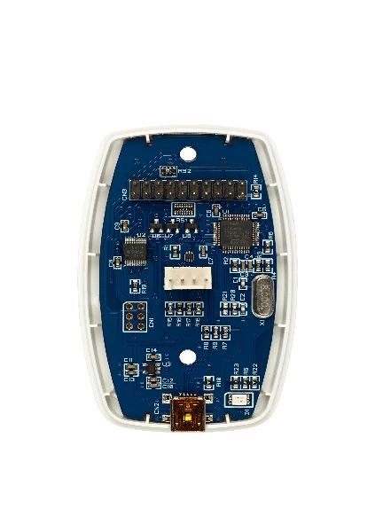

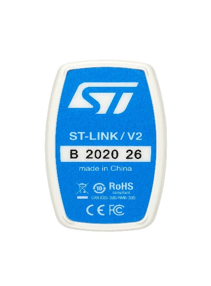

To answer the questions like "Is my ST-Link/V2 genuine? Where to find a genuine ST-Link/V2? Why my device isn't recognized?" and other related ones, please refer to the following:
ST-Link official in-circuit debuggers and programmers are available from standard STMicroelectronics distributors. Both STLINK-V3MINIE and STLINK-V3SET are usually available in volume, while the availability leadtime of ST-LINK/V2 may temporarily increase.
How to recognize a genuine ST-Link/V2
Should a ST-Link/V2 clone properly work with any ST tool or FW?
ST resources are dedicated to support genuine ST-Link products. We are not committed to ensure that clones are properly working with the firmware that we are delivering.

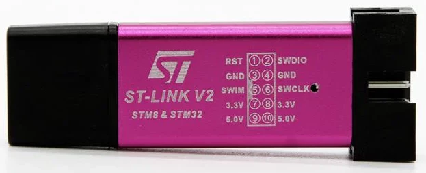

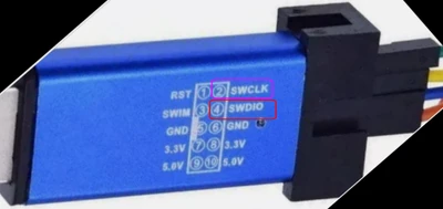

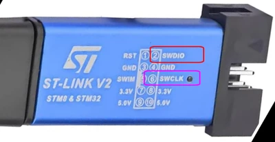

Note that anything looking like this is a fake/clone - even if it does have an "ST" logo on it:
There are many of these fakes/clones which all look identical, but they do not have consistent pinouts - the pinouts can be different, even when bought from the same place!

And RST is SWIM reset, not SWD reset signal. Moreover there are clones around which have totally weird pull-up/pull-downs on SWDIO and/or SWCLK. Causes communication to target to cease sporadically:
