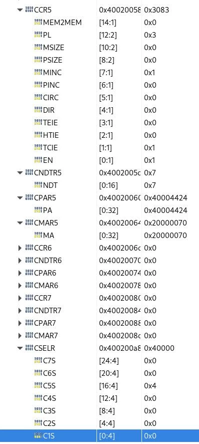

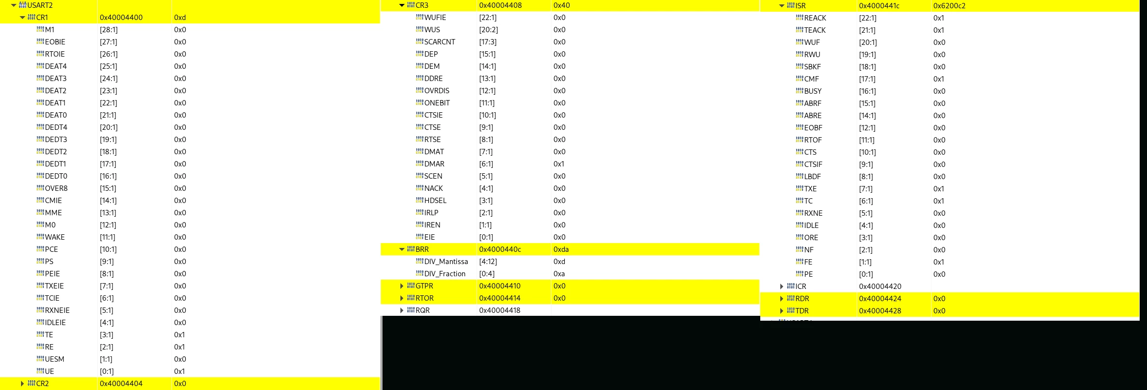

Archadious
November 18, 2024
waclawek.jan
November 19, 2024
FE status bit is suspicious, and also the RDR content - have you transmitted 0x00 to Rx pin?
Without writing any more code, try to
- stop program execution
- disable DMA by writing to its control register
- transmit one byte to the UART_Rx pin
- observe the UART registers - RXNE should be set (don't use "live registers view" or similar in IDE, which would repeatedly read the registers, as reading UART_RDR clears RXNE)
- stop observing the UART registers
- enable DMA
- look at the DMA registers, there should be a decrement in NDTR and the received byte should appear in the memory buffer
Archadious
November 27, 2024
A simple solution and an embarrassing oversight.
I finally noticed that I was setting pin A0 (USART2 RX) to AF4 rather than AF0.  My code now works correctly.
