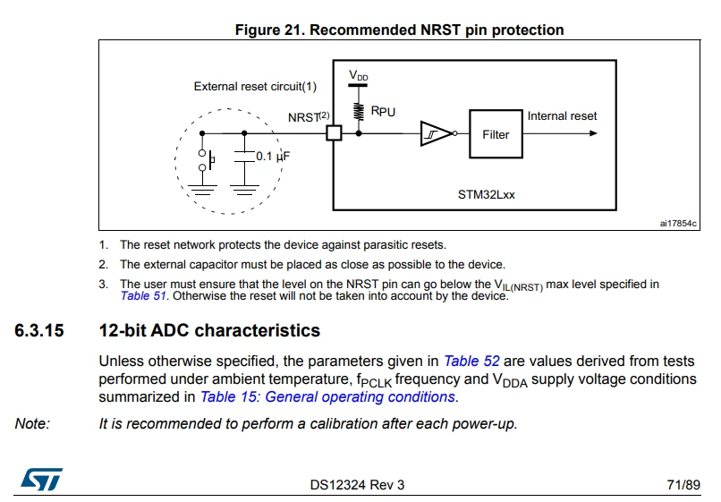

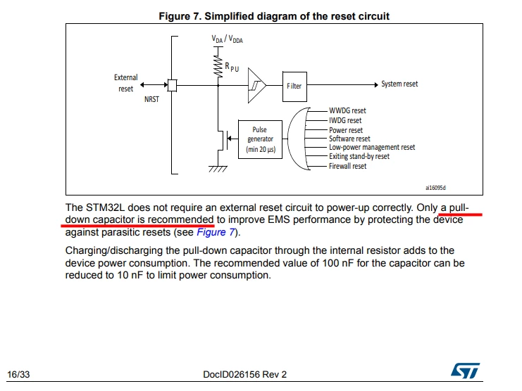

Presumably, it does start correctly if you just assert NRST ?
Similar issue here: MCU doesn't start after power cycle; Reset works OK
@LMehm wrote:
We suspect there may be an issue related to the reset circuit.
So have you looked at the reset signal with an oscilloscope? Does it meet the datasheet requirements.
It's recommended to have a capacitor on NRST - you don't have that:
PS:
In the datasheet:
https://www.st.com/resource/en/datasheet/stm32l010c6.pdf
LMehm
LMehmAuthor
Mar 31, 2026 11:26 AM UTC
Adding 100nF capacitor didn't help.
