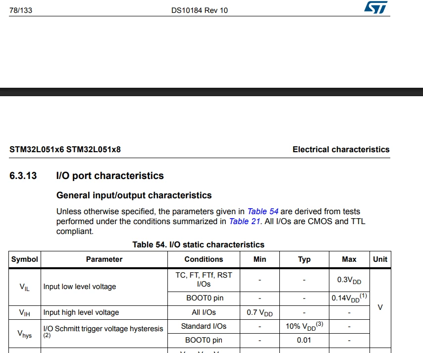

Hi, Does anyone know the default voltage level of an LPUART output as I am trying to interface with a device with a UART logic level of 1.8V so might need a level converter? Couldn't see anything about LPUART voltage on the datasheet?

The voltage specs would be the general IO pin specs
PS:
Picking an STM32L at random:

Essentially the same question here: STM32F723 USART TX and RTS drive capability.
It's defined by the GPIO specifications - not specific to the particular AF in use.
