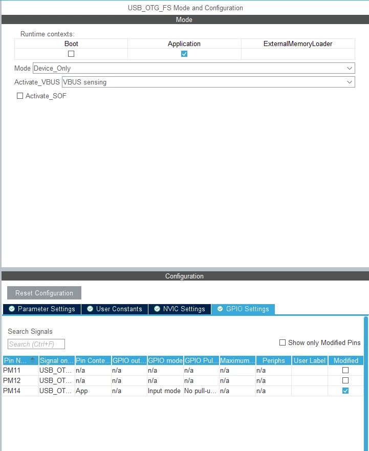

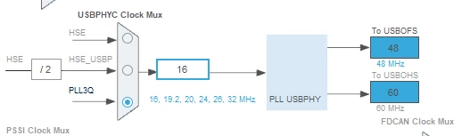

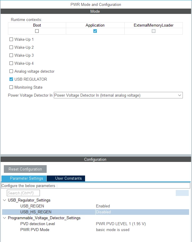

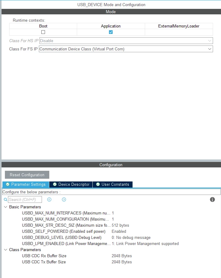

Hey, we have purchased the Nucleo board H7S3L8-B02. We always run in a timeout during USB core reset. This problem seems quite popular with multiple forum posts. However we still didn't manage to get it to run. I will give a set by step explanation of what we've done. Maybe someone catches the mistake. We made all of our settings in "Application", none in "Boot".
  • USB_OTG_FS settings:USB_OTG_FSUSB_OTG_FS
  • Middleware CDC settings:
CDCCDC
  • Power settings:PWRPWR
  • Clock settings (automatic by IDE)
CLKCLK

#include "main.h"
#include "usb_device.h"
static void MPU_Config(void);
int main(void)
 MPU_Config();
 /* Update SystemCoreClock variable according to RCC registers values. */
 SystemCoreClockUpdate();
 HAL_Init();
 MX_GPIO_Init();
 MX_USB_DEVICE_Init();
 while (1)
 /* USER CODE END WHILE */
 /* USER CODE BEGIN 3 */
 /* USER CODE END 3 */
 /* GPIO Ports Clock Enable */
 __HAL_RCC_GPIOM_CLK_ENABLE();
 /* MPU Configuration */
 MPU_Region_InitTypeDef MPU_InitStruct = {0};
 /* Disables the MPU */
 HAL_MPU_Disable();
 /* Disables all MPU regions */
 for(uint8_t i=0; i<__MPU_REGIONCOUNT; i++)
 HAL_MPU_DisableRegion(i);
 /** Initializes and configures the Region and the memory to be protected
 MPU_InitStruct.Enable = MPU_REGION_ENABLE;
 MPU_InitStruct.Number = MPU_REGION_NUMBER0;
 MPU_InitStruct.BaseAddress = 0x0;
 MPU_InitStruct.Size = MPU_REGION_SIZE_4GB;
 MPU_InitStruct.SubRegionDisable = 0x87;
 MPU_InitStruct.TypeExtField = MPU_TEX_LEVEL0;
 MPU_InitStruct.AccessPermission = MPU_REGION_NO_ACCESS;
 MPU_InitStruct.DisableExec = MPU_INSTRUCTION_ACCESS_DISABLE;
 MPU_InitStruct.IsShareable = MPU_ACCESS_SHAREABLE;
 MPU_InitStruct.IsCacheable = MPU_ACCESS_NOT_CACHEABLE;
 MPU_InitStruct.IsBufferable = MPU_ACCESS_NOT_BUFFERABLE;
 HAL_MPU_ConfigRegion(&MPU_InitStruct);
 /* Enables the MPU */
 HAL_MPU_Enable(MPU_PRIVILEGED_DEFAULT);
void Error_Handler(void)
 __disable_irq();
 while (1)
#ifdef USE_FULL_ASSERT
#endif /* USE_FULL_ASSERT */
 _hal_msp.c
#include "main.h"
void HAL_MspInit(void)
 PWR_PVDTypeDef sConfigPVD = {0};
 /* System interrupt init*/
 /** PVD Configuration
 sConfigPVD.PVDLevel = PWR_PVDLEVEL_1;
 sConfigPVD.Mode = PWR_PVD_MODE_NORMAL;
 HAL_PWR_ConfigPVD(&sConfigPVD);
 /** Enable the PVD Output
 HAL_PWR_EnablePVD();
 /* Enable USB Voltage detector */
 if(HAL_PWREx_EnableUSBVoltageDetector() != HAL_OK)
 /* Initialization error */
 Error_Handler();
 HAL_PWREx_EnableUSBReg();
  • usbd_conf.c
void HAL_PCD_MspInit(PCD_HandleTypeDef* pcdHandle)
 RCC_PeriphCLKInitTypeDef PeriphClkInit = {0};
 if(pcdHandle->Instance==USB_OTG_FS)
 /* USER CODE BEGIN USB_OTG_FS_MspInit 0 */
 /* USER CODE END USB_OTG_FS_MspInit 0 */
 /** Initializes the peripherals clock
 PeriphClkInit.PeriphClockSelection = RCC_PERIPHCLK_USBOTGFS;
 PeriphClkInit.UsbOtgFsClockSelection = RCC_USBOTGFSCLKSOURCE_HSI48;
 if (HAL_RCCEx_PeriphCLKConfig(&PeriphClkInit) != HAL_OK)
 Error_Handler();
 /** Enable USB Voltage detector
 HAL_PWREx_EnableUSBVoltageDetector();
 /**USB_OTG_FS GPIO Configuration
 PM14 ------> USB_OTG_FS_VBUS
 GPIO_InitStruct.Pin = GPIO_PIN_14;
 GPIO_InitStruct.Mode = GPIO_MODE_INPUT;
 HAL_GPIO_Init(GPIOM, &GPIO_InitStruct);
 /* Peripheral clock enable */
 __HAL_RCC_USB_OTG_FS_CLK_ENABLE();
 __HAL_RCC_USBPHYC_CLK_ENABLE();
 /* Peripheral interrupt init */
 HAL_NVIC_SetPriority(OTG_FS_IRQn, 0, 0);
 HAL_NVIC_EnableIRQ(OTG_FS_IRQn);
 /* USER CODE BEGIN USB_OTG_FS_MspInit 1 */
 /* USER CODE END USB_OTG_FS_MspInit 1 */
