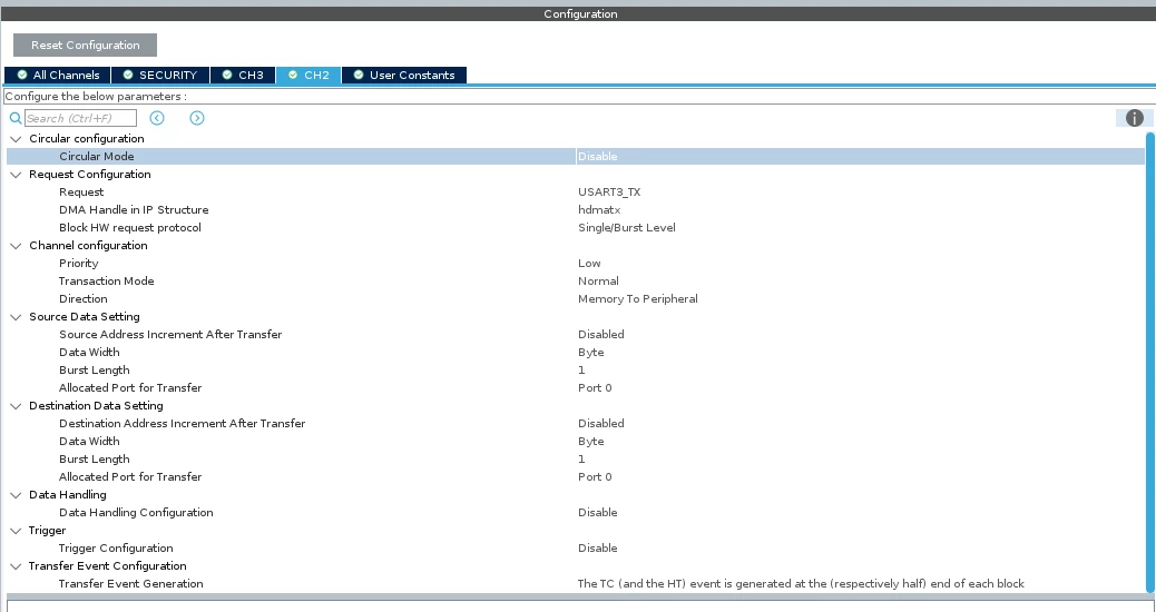

I want to setup USART3 TX transfers using GPDMA, however, without success.
For such purpose I also followed this article: https://community.st.com/t5/stm32-mcus/how-to-configure-the-gpdma/ta-p/49412
STM32CubeMX setup is:
USART TX DMA Chan
The code for usart is the following:

If I use the USART transmission without DMA, it works fine (using USART_Printf function).
But using the DMA nothing is transmitted (using USART_DMA_Printf function), and neither IRQ is generated.
So what is wrong in this setup?
Thanks,
s.

Hi @simo zz ,
Try to start with an example ready to use available examples in STM32CubeH7RS like STM32CubeH7RS/Projects/NUCLEO-H7S3L8/Examples/USART/USART_SlaveMode_DMA.
You can even take the .ioc file and update it depending on your application case.
-Amel
