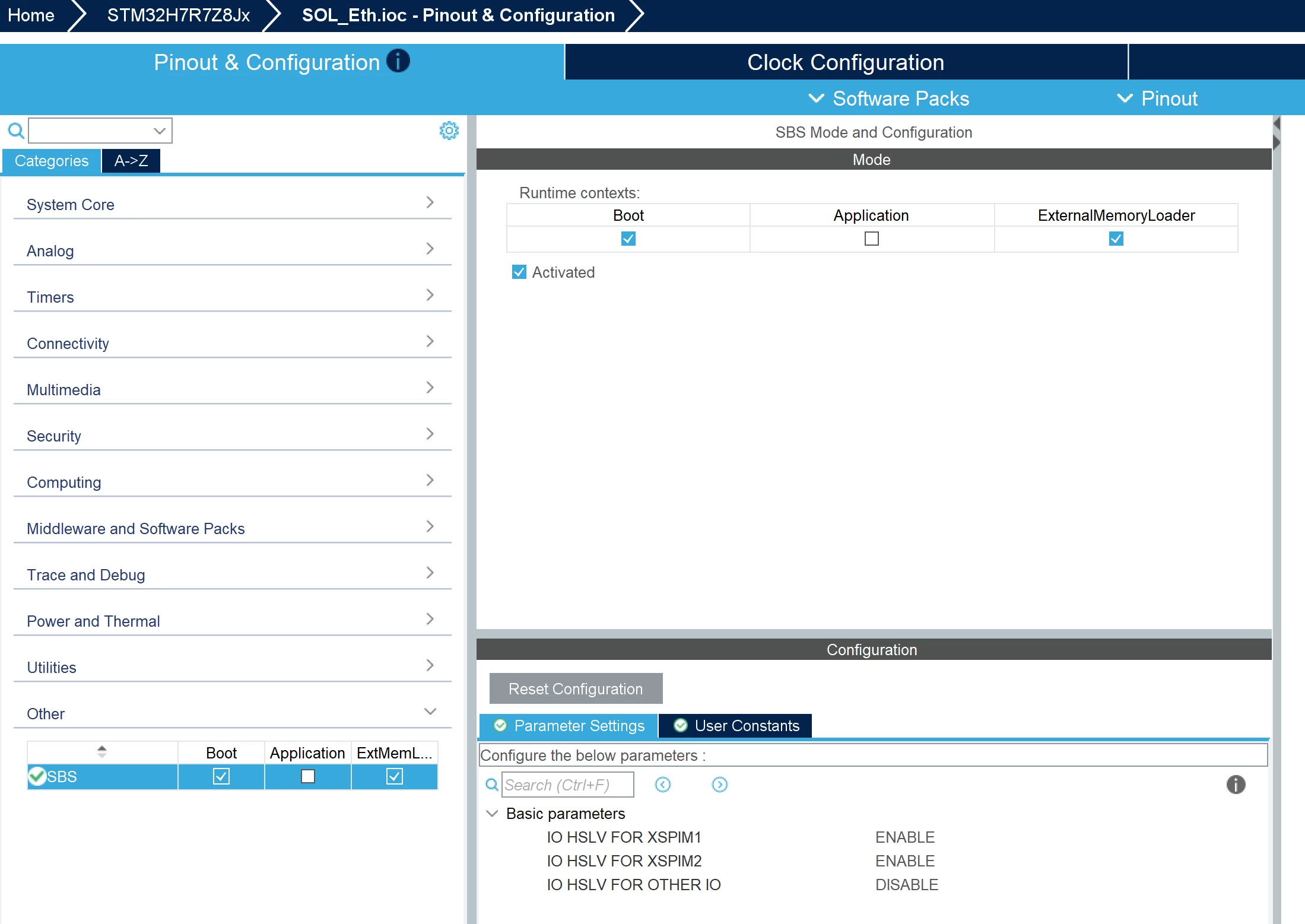

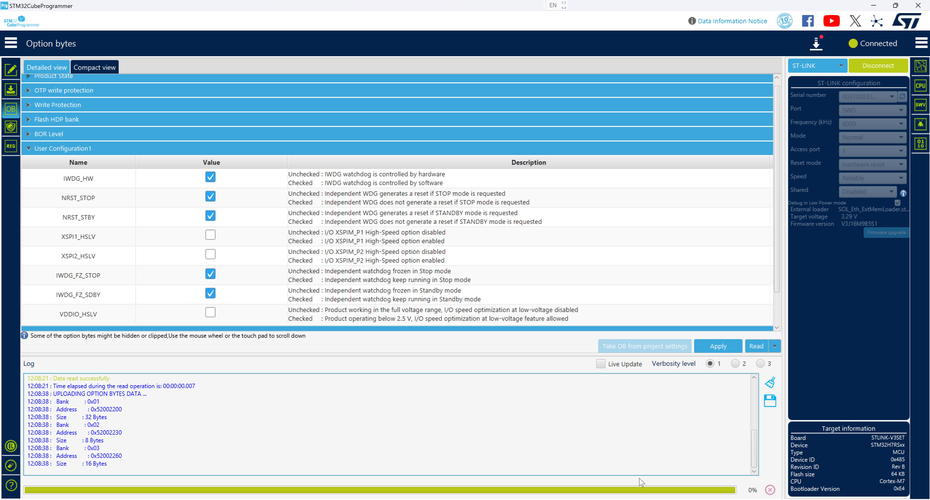

March 11, 2026
Hi Kaouthar, Thanks for your reply!
For HSLV, I checked the high-speed-option are disabled on both XSPI 1 and 2. See:
But the HSLV are enabled from MX->SBS. Shall I disable it too?
We will check the I/O/compensation from errata 2.2.15, and get back later.

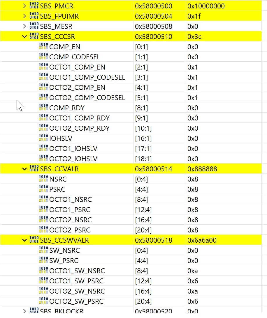

2) Then apply SW I/O compensation on XSPI (Follow workaround from Errata 2.2.15)
The value of flash memory at address 0x08FFF840 @3.3 V is 0xFFFFFFFF. So we go with case-1: The calibration value from register SBS_CCVALR is 8. The result shows the SW compensation does not help in high speed, and a little bad with low speed:
XSPI-2 Clock (MHz)Total BytesError BytesError Rate
1338MiB527700 ~ 6856948.57%
66.58MiB800 ~ 1191200 PPM
33.258MiB13 ~ 304 PPM
Double check the SBS registers:
Summary:
  • The DQSE bit of the XSPI_WCCR register is set for doing memory-mapped writes.
  • Both XSPI1_HSLV and XSPI2_HSLV are disabled.
  • Automatic I/O compensation is disabled in XSPI1 and XSPI2, with or without SW compensation applied.
All these can't fix the unstable problem. Any suggest?

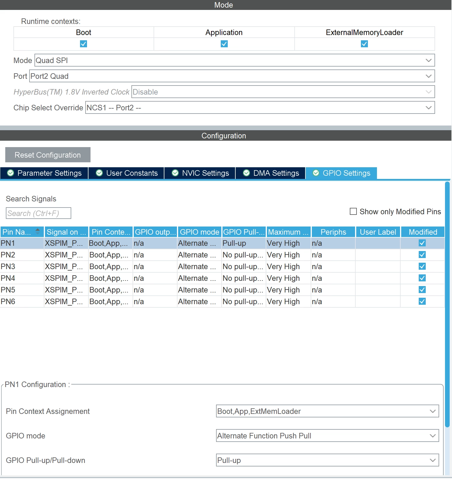

Leo2RuanAuthor
March 13, 2026
Hi @KDJEM.1
The VDD for MCU and PSRAM is 3.3v. It is confirmed that I/O HSLV is not set on my board.
To avoid the damage case, I checked the HSLV and do all tests on 3 boards. Get same result.
I did not check the pin-mux settings since this is generated by MX.
Thanks!
