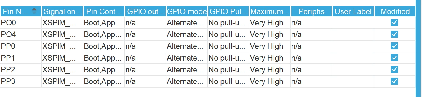

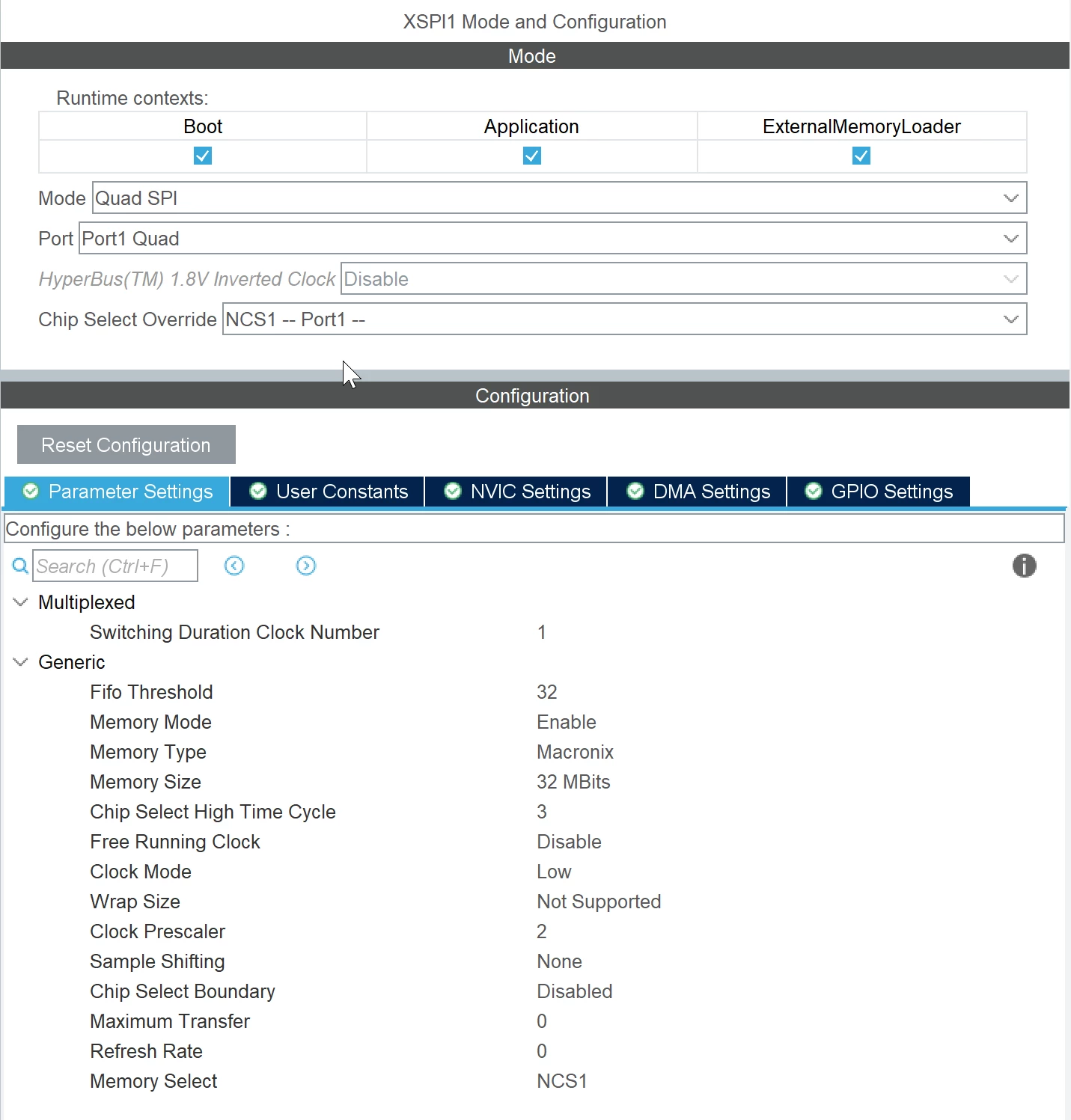

2) XSPI1 settings and GPIOs
There 4 memory types available and no 'custom' option. I pick the 'Macronix' as it is most close to AT25XE321D.

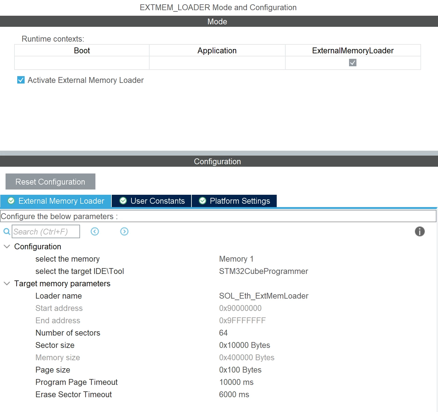

3) ExtMemLoader settings
I also go through followings but did not help me to solve the problem:

The problem is fixed by setting 'memory-mode' from enable to disable in MX. This generated diff code as below:
