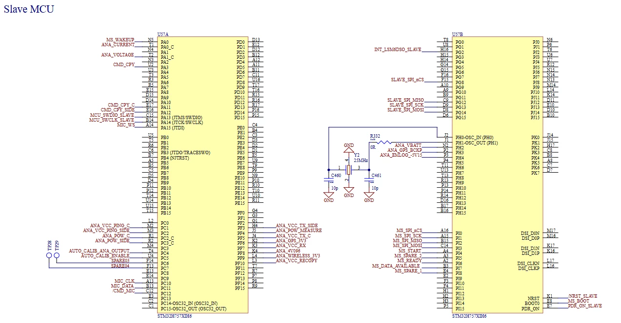

3 replies
Sep 29, 2026 4:34 PM UTC
Probably another bootloader interface was activated so it’s no longer monitoring SPI2 anymore. Look at other active pins that the bootloader listens to. Post schematic.
Byann.1
Byann.1Author
Sep 30, 2026 6:17 AM UTC
Thank you for the suggestion. We looked at this early on, and the evidence says the bootloader is still on SPI2.
1. The bootloader has selected SPI2 and kept it.
We attached to the running slave over SWD (hot-plug) on a failing board. In RCC, only the SPI2 clock is enabled. The USART, I2C, FDCAN and USB clocks are off. SPI2 is configured as a slave (mode 0, hardware NSS) with its TX fed by DMA1 Stream 1 in circular mode. The bootloader is not faulted and is executing normally. This matches the interface selection flow in AN2606 (Figure 60), where the other interfaces are de-initialized once one is detected.
2. The slave is listening on SPI2 and answering, but the answer is wrong.
After 0x5A it returns 0xA5 on every poll, forever. SR.UDR is 1 on failing boards and 0 on working boards. The SPI2 TX DMA buffer contains 20 bytes of 0xA5, with no 0x79 in it.
3.Here is the schematic on slave
Byann.1
Byann.1Author
