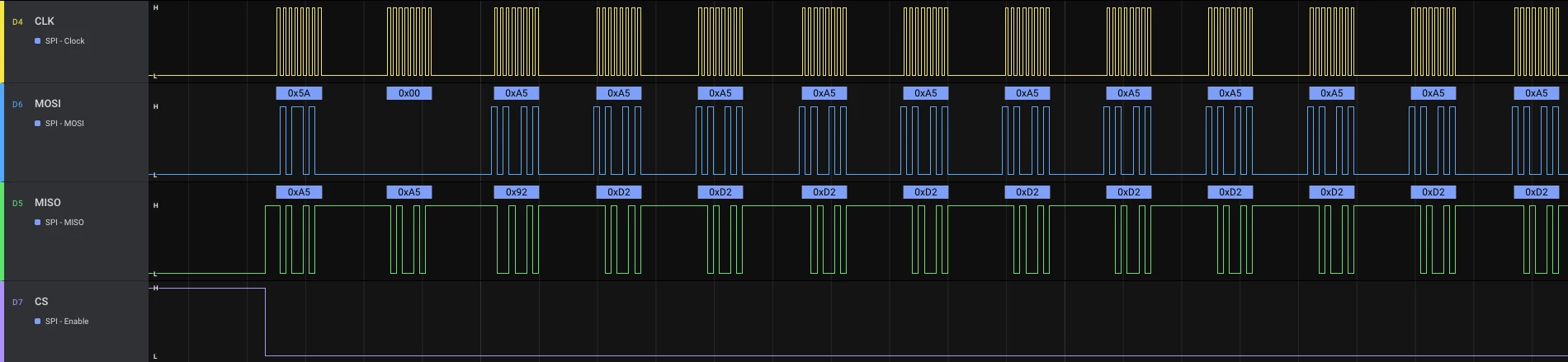

SPI Bootloader Synchronization Issue

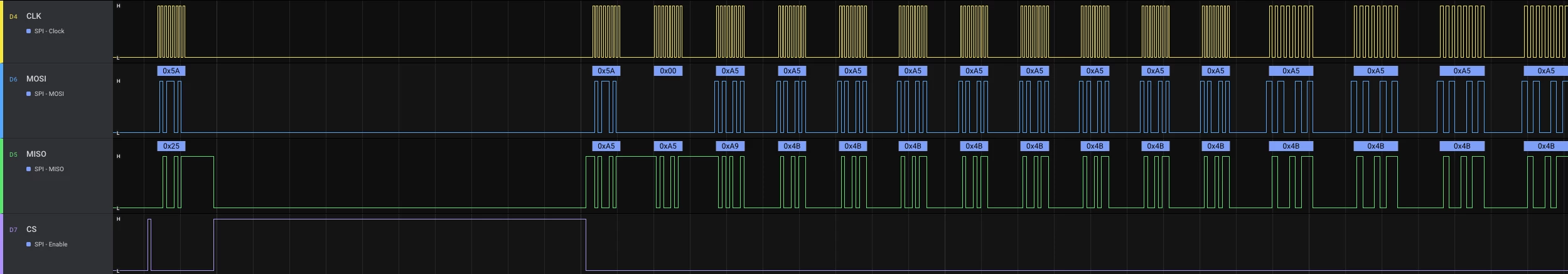

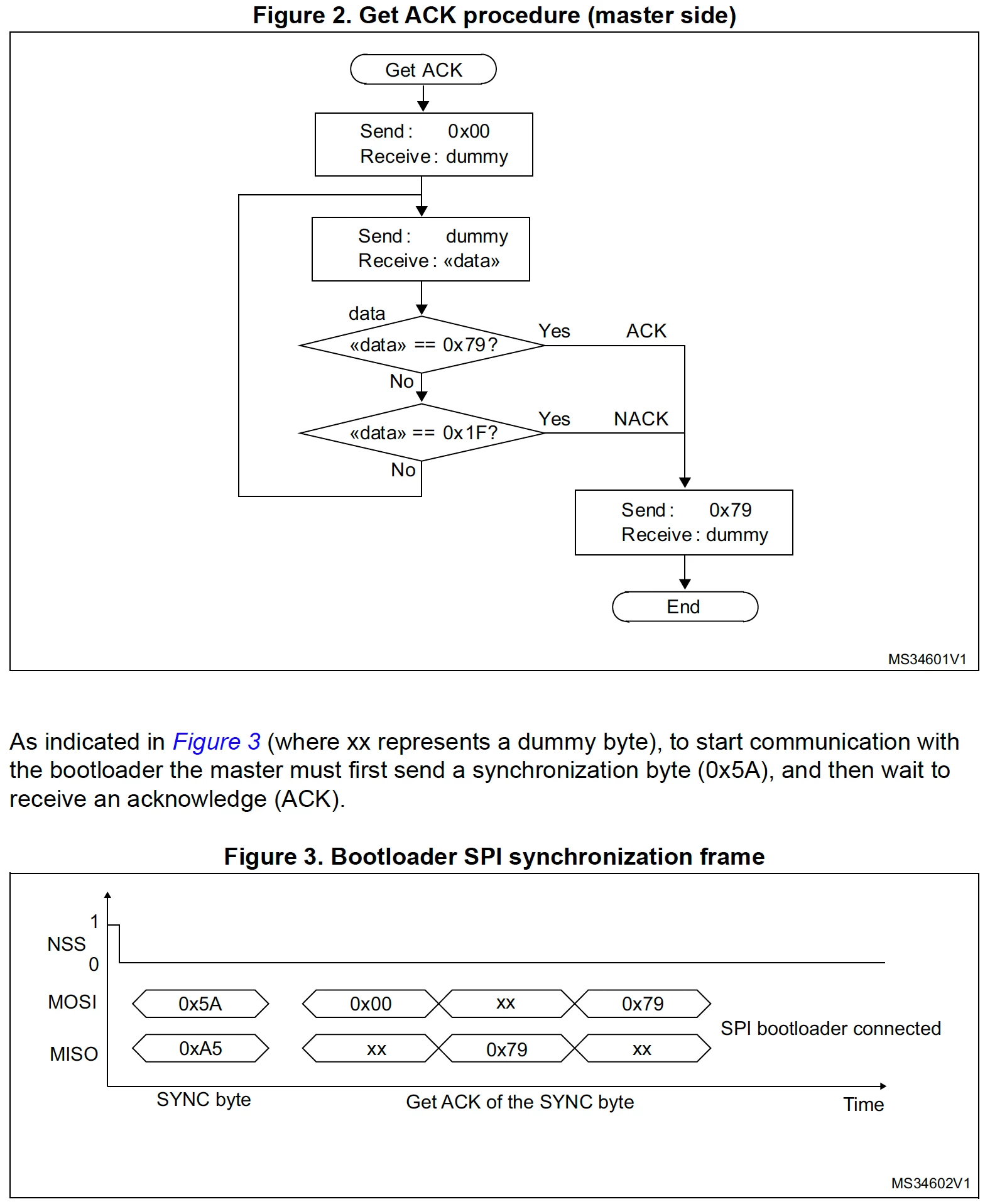

I'm following the bootloader ACK procedure outlined in AN4286, page 6.
The issue I'm having is that the bootloader never responds with 0x79 (ACK) or 0x1F (NACK) after the initial synchronization (Sent 0x5A, Received 0xA5).
Are there any issues with my understanding of the procedure? I'm assuming the dummy byte first sent by the bootloader is supposed to be used throughout the procedure?
I'm using STM32H750B-DK with erased flash memory, and proper PI0, PI1, PI2, PI3 pins for SPI2 as outlined in AN2606, page 263.
SCK is pulled down to GND with a 10k resistor, NSS is pulled down at the start of every transaction (tying it to GND as suggested in the docs seems to work worse).

Able to get to ACK by sending 0x00 instead of the initial dummy byte, but it takes 40 attempts.

Dec 1, 2021 11:21 PM UTC
What's the time scale here? Are you waiting 8+us between the first and second byte as required per AN2606?
dscdsc
dscdscAuthor
Dec 1, 2021 11:24 PM UTC
Yes, the interval between the transfers (on the right side of the image) is 1ms.

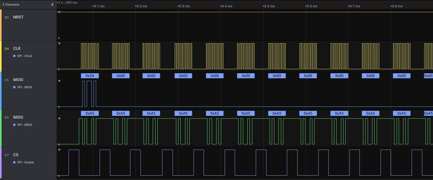

Dec 1, 2021 11:29 PM UTC
It would be nice to see the full scope trace from reset. You have stuff happening before the sync byte which makes me think it may already be in the bootloader. The sync frame is only done once to enter the SPI bootloader.
dscdsc
dscdscAuthor
Dec 2, 2021 12:58 AM UTC
Here's the trace from reset.

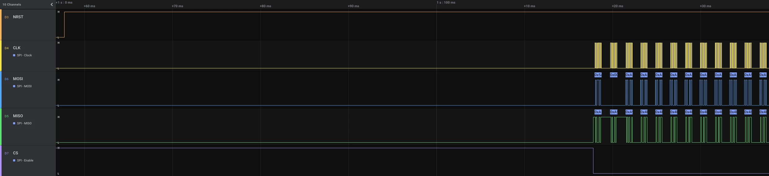

Dec 1, 2021 11:35 PM UTC
Here's the different but equally disappointing results when using SPI1 (PA4, 5, 6, 7).

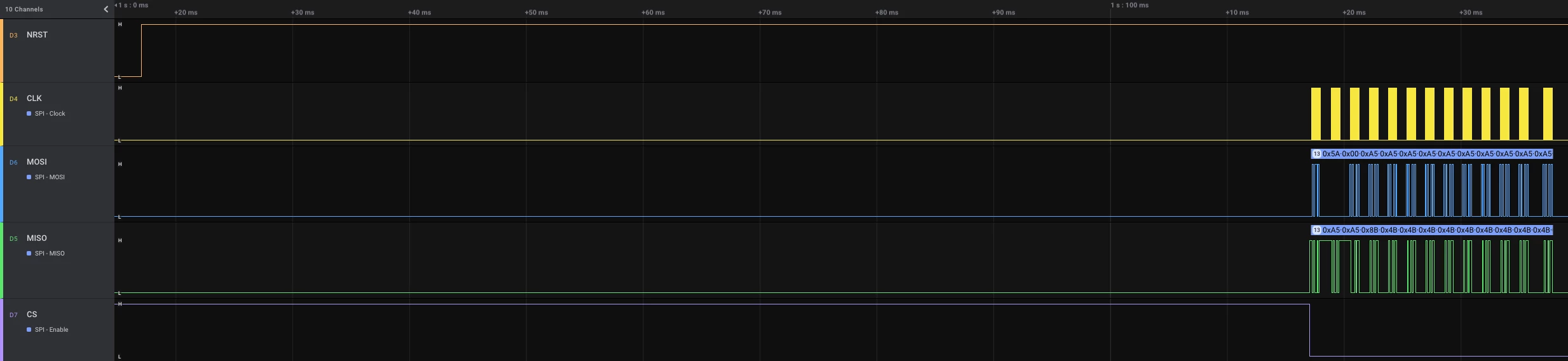

Dec 2, 2021 1:30 AM UTC
And the same result for SPI3 (PC12, 11, 10, PA15).

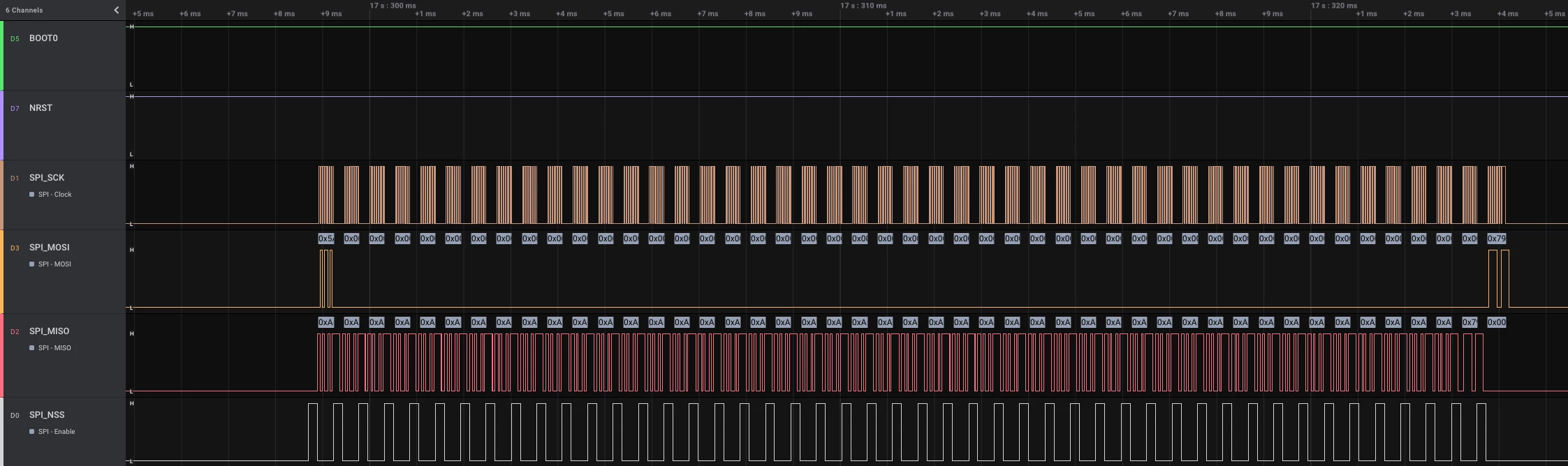

Dec 2, 2021 2:04 AM UTC
Seems like my understanding is correct as it matches the behavior in this SPI bootloader host implementation.

Dec 2, 2021 10:49 PM UTC
Getting essentially the same result when using an another STM32H7 as a bootloader host. Just running the example from the implementation in the previous post.

I appreciate you posting updates. I don't have any further ideas, looks like you're doing everything correctly as far as I can tell.
I have several H7 boards so maybe I'll try it out as well.
