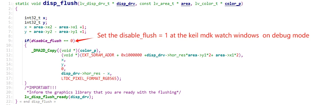

     Try to disable _DMA2D_Copy by set the global variable “disable_flush” to 1 in the route disp_flush in the lvgl disp port  file lv_port_disp_template.c  in order to stop any update on ltdc framebuffer.
        But I still see the issues.

      I can see LTDC_IER_FUIE Error , After enable the LTDC_ER_IRQHandler while LCD flicker.

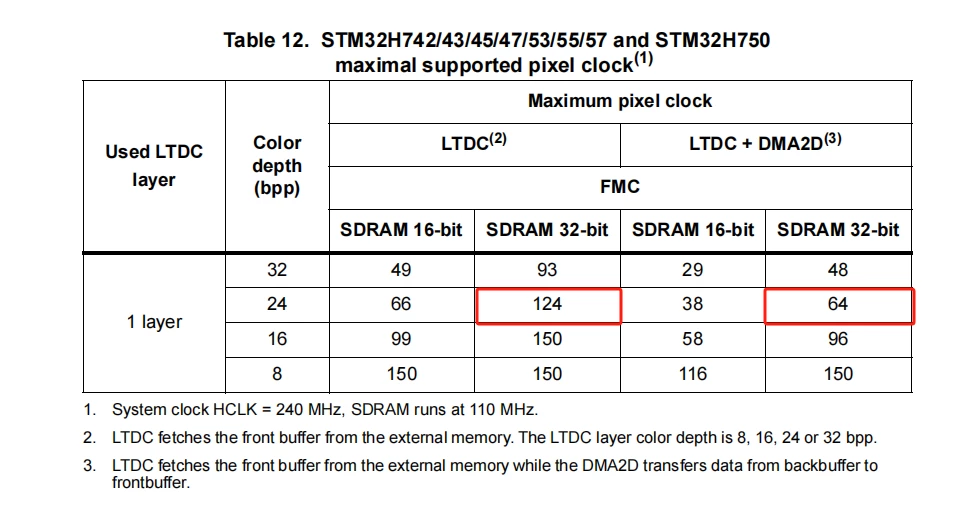

I recommend you to check the AN4861 and precisely section 4.2.2 Checking display compatibility considering the memory bandwidth requirements. This section explains how to check a display compatibility considering the framebuffer memory bandwidth. Also can help you to determinate pixel clock and LTDC required bandwidth.

Hello Kaouthar,
       Let me show our hardware config information:
        MCU M7 Clk: 480Mhz
        QSPI: 32MB  run at 4-wire mode(App Fw Code is running at QSPI)
       TFT-LCD: 1024X600  16bit ,LCD_CLK: 55MHZ , LTDC layer = 1
        SDRAM: 32-bit  32MB
        System clock HCLK = 240 MHz, SDRAM runs at 80 MHz  (Also test 120MHZ but have no effect)
       I have double checked the AN4861 and precisely section 4.2.2 Checking display compatibility considering the memory bandwidth requirements.
      20240315164949.png         Current the LCD Clk is 55Mhz, So, I think it is ok for  the memory bandwidth requirements.
         Maybe  some unknown reasons have increased the sdram access load,
         Can you take a look my test result?
