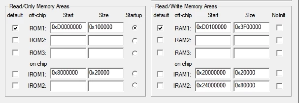

I use STM32H750XBH6, Flash is 128kBytes.
My Program is too big,so I Write a BootLoader to load the program into sdram ,and run it in sdram.
This is the setting of my APP in keil,
This way can run the program successfully , but I cannot debug APP in Keil.
How Can I Debug APP in Keil?
Thanks!

Dear @Passerby ,
I assume this Application Note was used :
https://www.st.com/resource/en/application_note/an5188-external-memory-code-execution-on-stm32f7x0-value-line-stm32h750-value-line-stm32h7b0-value-line-and-stm32h730-value-line-mcus-stmicroelectronics.pdf
there is a particular hint at the end when using IAR EWARM, I would say there is similar technique for Keil/ARM MDK as well . Hope it helps you .

Hello @STOne-32
     I can jump to the APP runtime, but I don't know how to Debug in Keil.
     I can only use printf for debug right now
Thanks!

Odd Coincidence... This was posted today in the knowledge base:
https://community.st.com/t5/stm32-mcus/debugging-in-external-memory-on-stm32cubeide/ta-p/705333
Targets CubeIDE, but may give you hints for achieving same in KEIL. There's also a link to a training video on youtube.

Hello @BarryWhit
    Thank you for your reply. I can debug using Qspi-Flash, but I don't know how to debug using Sdram!
