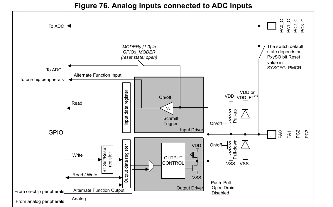

Probably you killed a xx_c pin.
It happened to me when using such an pin for SPI to a small display. It was working until I tested it with higher clock rate. Was working some seconds then died away.
This pin never worked again.
So I avoid these xx_c pins for any output signal, just using it as a slow input is okay, or as analog input.
The _c pins are connected through an anlog switch - that can easily be destroyed ....
So maybe you killed it by driving more than 1mA on these pins...
https://community.st.com/t5/stm32-mcus-products/stm32h723-ulpi-and-pc2-c-pc3-c/m-p/867985#M290807
Check: set pin as gpio output (remove connected hardware, that drives this pin) and toggle it, just for test: check with scope, pin working or not.

The reason why I think it's a problem with the STM32H7, and not the USB3300, is because DIR and NXT are both low, which should imply that the mcu is good to put data on the data bus, but that never happens. I did write a little program to check the value of pc2 and pc3 and they both came back low though, even when I enable the internal pull-up resistor. So it seems like the analog switch might be okay.
