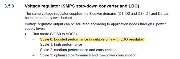

That's normal. You're using SMPS in boosted performance (VOS0) which is not allowed in the spec.
In SMPS configuration, the maximum frequency you can reach is 400MHz @VOS1. Only LDO can be used with VOS0.
This is already mentioned in the datasheet:

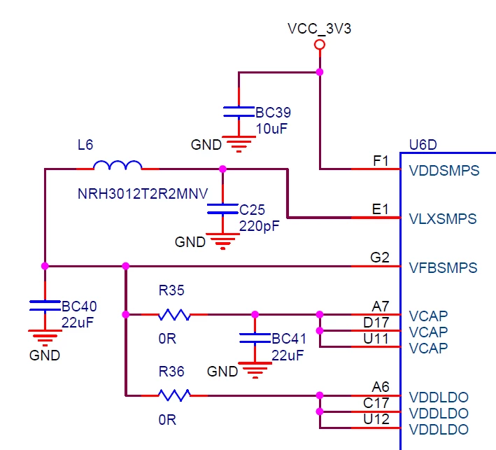

Welcome in STCommunity, indeed seems a strange behavior - if you can share your power  schematics for a sanity check , also you can check this Knowledge base : https://community.st.com/t5/stm32-mcus/unable-to-connect-to-stm32h7-devices/ta-p/49296

I would appreciate it if you could refer to the picture above.
above picture is direct SMPS supply mode schmethics.

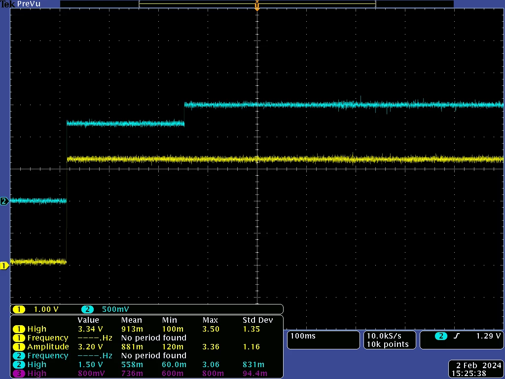

room temperature is well powering On & powering Off.
Conneting ST-Link V2/V3 is very well too.
but below -10°C Temperature, sometimes doesn't powering On.
plus, i can't connet ST-link V2/V3 too.
umm.. and Vcore Voltage is 1.5V.
Reference manual & User Manual explained direct SMPS supply mode is can set up to VOS1.
and Vcore Voltage max value is 1.26V.
current My Setting is below :
1. direct smps supply mode
2. v scale 0
3. wait for vosrdy flag
4. and application start
and then, My situation right now is 0.24V over.
Could this also cause the problem?

May be : BC41 value seems very high and should be 2,2uF , BC40 value is too high also / close to the inductor .
Also as said by @STOne-32 22uF is not the right value recommended for VCAP pins.
Please refer to NUCLEO-H745ZI-Q board schematics:
https://www.st.com/resource/en/schematic_pack/mb1363-h745ziq-d01_schematic.pdf
