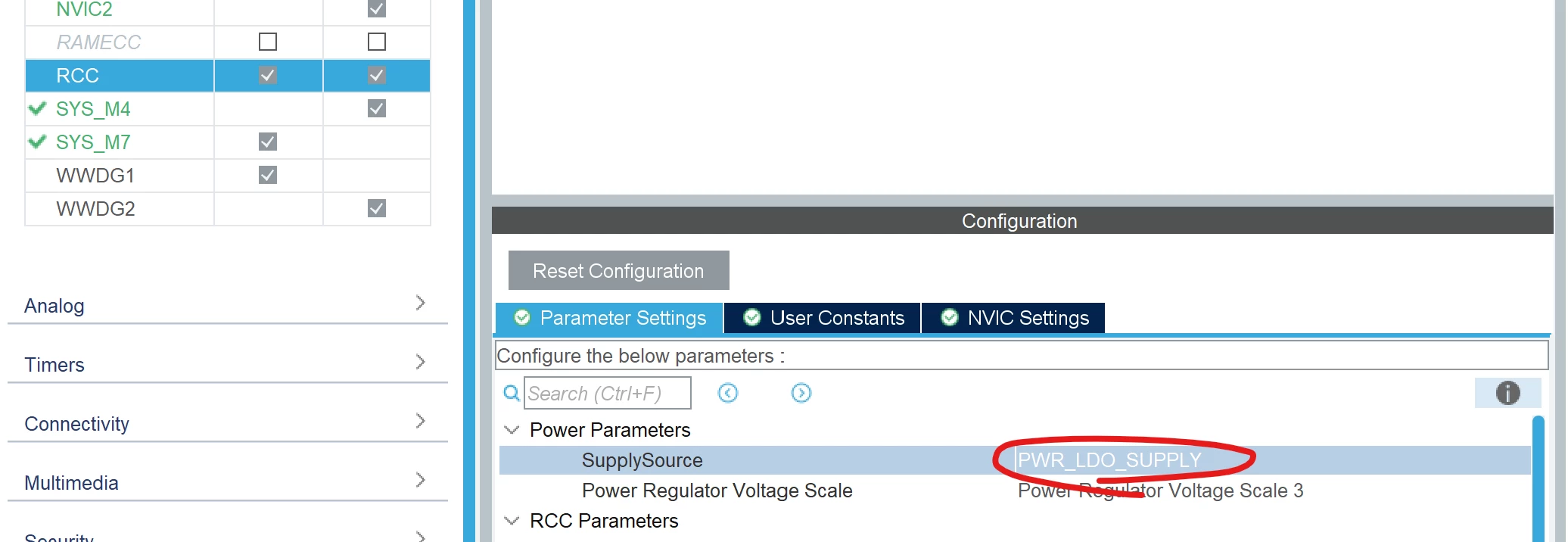

> HAL_PWREx_ConfigSupply(PWR_DIRECT_SMPS_SUPPLY);
This doesn't match your schematic. You want PWR_LDO_SUPPLY.
Unable to connect to STM32H7 devices - STMicroelectronics Community
Change it here:

October 18, 2025
Thank you so much. I just wanted @TDK to let you know that you have helped someone not only troubleshouting a simple error but to acomplis his goals and enjoy this hobby. Thanks for your work.
