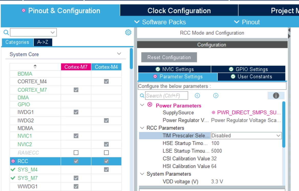

I noticed that the STM32CubeMX shows an error in the RCC configuration. So, please check the parameter settings?

@KDJEM.1 Thanks for an answer!
The CubeMX configuration is not relevant, because it's a pain to regenerate code each time after some field changed. And this particular error is a known bug of CubeMX: it doesn't allow to select PWR_DIRECT_SMPS_SUPPLY although it is used in original examples and works fine @480MHz.

Hello @VHEMaster,
This FAQ can help you on How to reach 480MHz on system clock for STM32H7xx MCUs using STM32CubeMX?
Please update your toolchain and the STM32Cube firmware and let me know if the issue is solved or not?

February 18, 2025
@KDJEM.1 Unfortunately, it doesn't solve an issue of no DSI video output.
