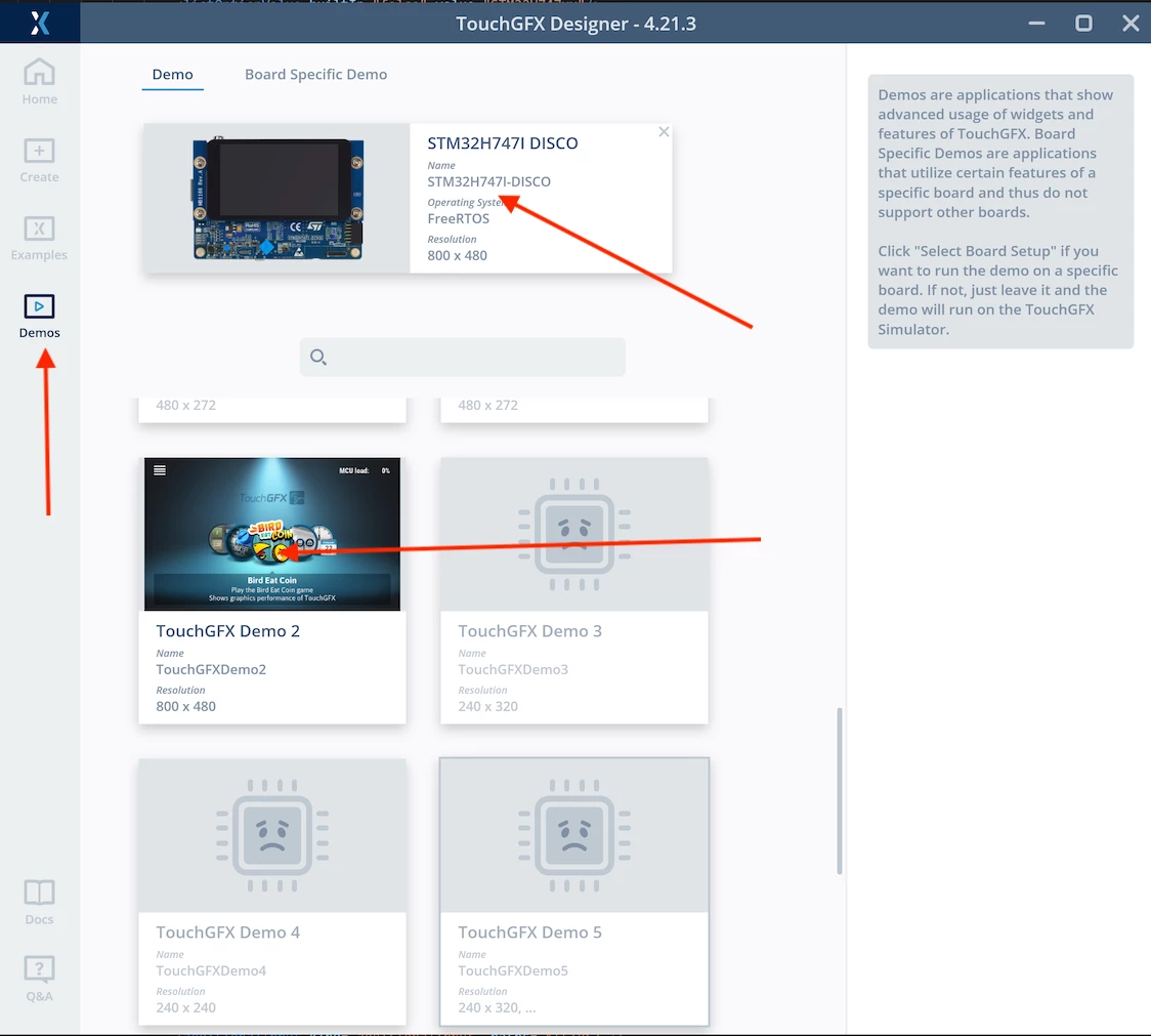

JSext.1
May 6, 2023 7:55 AM UTC
Yes, the TouchGFX demos worked to my surprise. Once flashed, I found my old code written in CubeIDE could then be flashed as normal. If I flashed directly on a new board without first loading something (even a blank screen from TouchGFX), my CubeIDE code crashed the board​. Not sure if that helps anyone, but just my experience yesterday.
ACapo.1
May 6, 2023 7:02 AM UTC
As you are having trouble flashing this you could install TouchGFX, the demo is contained in there, create a project in TouchGFX using the board and the demo and then you can flash it from within TouchGFX, it will handle everything for you.
BRobe.3
May 7, 2023 7:36 AM UTC
Thanks for your answer.
I don't thik that Demo2 is the basic demo. Anyway, it failed.(below the end of reporting)
Other demos are working for example COVER TRANSISTION
Best Regards
Robert

Jan 5, 2024 7:07 PM UTC
I just had the same issue, even the reset button was doing nothing.
I connected the board, detected by the Programmer, then I pushed one of the touchGFX samples. and all went fine.
It seems the board came blank!
