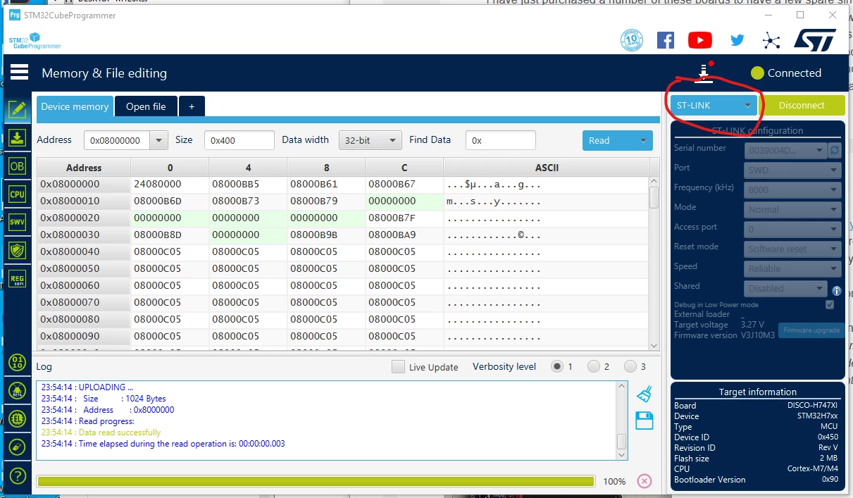

BSam.1
May 1, 2023 6:53 AM UTC
Hi, All,
I just received my new STM32H747I-DISCO from Newark, and it behaves as @yakabmarci​ 's board: only the two LEDs lit up, and no demo. The board was recognized by Windows 10 Device Manager (as STLink Virtual COM Port), but unfortunately no more signs of life.
-- STM32 Cube Programmer was not able to connect to the board, saying, "Error: Establishing connection with device failed" and "No DFU detected".
-- @peter_3993 BENSCH​ mentioned that "compiled demo can be found on the STM32H747I-DISCO product website in the subfolder STM32H747I-DISCO_demo/Binary". Well, I tried the thousand places to click on that web page and cannot find any "subfolder" , nor anything named "compiled demo". Where can this demo be found? Also, where is this batch file that is supposed to load the demo?
-- What can I do to get the board back to life?
_legacyfs_online_stmicro_images_0693W00000bj7YmQAI.png Thanks for your help in advance!
Benjamin
Peter BENSCH
May 1, 2023 5:13 PM UTC
My statement above "the compiled demo can be found on the STM32H747I-DISCO product website in the subfolder STM32H747I-DISCO_demo/Binary" means:
  • the URL behind compiled demo directly points to that compiled demo. All you have to do is click on the URL (the blue text), download the ZIP and then unpack it.
  • the URL behind STM32H747I-DISCO points to the Discovery product website, where you can find the same demo bin under the tab Documentation > Compiled Demos, after unpacking the demo ZIP, you will find the actual BIN under STM32H747I-DISCO_demo/Binary.
In the meantime I have expressed the previous statement a little more comprehensibly and corrected it accordingly above, I would like to apologise very much for the problems of understanding.

BSam.1
May 1, 2023 7:00 AM UTC
Update: clicking the button on STM32 Cube Programmer that says "USB" and selecting "STLINK" on the pull-down menu enabled connection, resulting to the screen below, so I presume that if I can find the demo firmware it could be downloaded, right?
Peter BENSCH
May 1, 2023 5:34 PM UTC
Theoretically correct, but not quite sufficient, because an external flash must also be programmed, which must first be communicated to the STM32Cube programmer.
To make your work easier, however, you will find in the demo ZIP not only the HEX that contains the programme for the STM32H747 as well as for the external data flash, but also the appropriate BAT file for fully automated programming.
Since the BAT file is not encrypted, the command sequence can also be used for other operating systems if it is adapted accordingly.
Hope that helps?
Regards
/Peter
BSam.1
May 12, 2023 3:37 PM UTC
Thank you, Peter -- Yes, it helped. Thanks for fixing the link to the demo page also. Of course if I had read your instructions more carefully before clicking everywhere at random I'd have found the demos earlier ;-).
Strangely, though, the demos (both Fruitti & GFX) didn't seem to have loaded at first, and only appeared after I left the setup overnight. The Fruitti game worked as expected after the splash screen showed up, but the GFX demo just put up a stale first screen. It didn't do anything until after multiple plugging and unplugging of the USB, and pressing every button. I didn't know which button finally did the trick, but the screen transition was painfully slow -- taking multiple seconds -- nothing like what you see from the "Getting started" video.

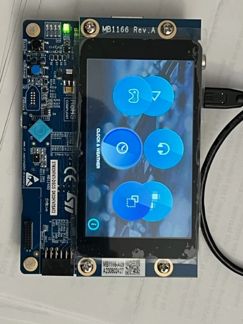

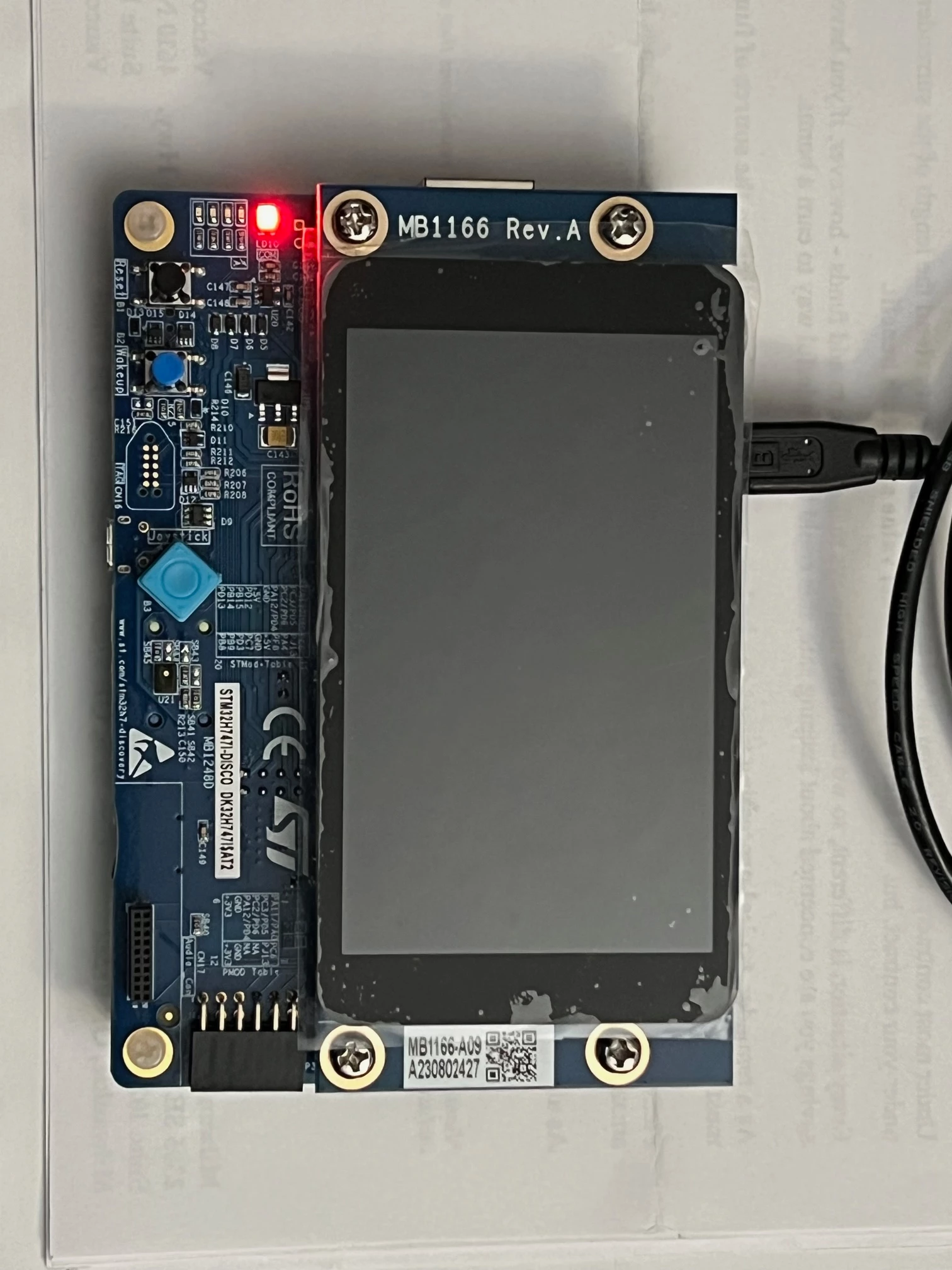

BRobe.3
May 3, 2023 8:59 AM UTC
Hello Peter,
Thanks for your help. As mentionned in another post, I have also a Discovery Kit stm32h747i-disco (Coming from mouser without blister) which does nothing just two LEDs light up, One red on top and one green on back.
I read carefully all your recommendations. I get the en.STM32H747I-DISCO_demo. In Binary, I used the program_hexfile.bat file which looks to works well. I got the execution file with file boot and erase status and then, I got the loading progress bar. This progress bar disappeared at 92%. Nothing say, if the recording is right ?
Anyway, I was thing to have something on the screen but it remain black.
I understood, program_hexfile.bat program both internal Flash and external QSPI memory. Is that right ?
In the readme,txt, they talk of the file "STM32Cube_Demo-STM32H747I-DISCO-VX.Y.Z_FULL.hex" when in binary the file is STM32Cube_Demo-STM32H747I-DISCO-V1.0.0_FULL,hex. Is that an issue.
I also programm a flash 32 Gb, as mentionned in the text. I Checked images,sounds and videos on the computer. Everything looks Good. Anyway, I imagine, even without flash, the demo programm should show at least a menu. Is that right ?
What is wrong ?
Best Regards
Robert
Piranha
Principal III
May 5, 2023 11:38 PM UTC
Seriously? No capabilities of figuring out on your own what those letters with dots might mean?
BRobe.3
May 5, 2023 2:19 PM UTC
Some news about this issus not yet solve for me.
I used the program_hexfile.bat file again. I got the loading progress bar. This progress bar disappeared at 96%. The screen was still black after completion.
But, at that time, I restart my computer for another reason, the disco 747 board beeing still connected. And suddenly, the demo appeared. It was working well.
Then, I disconnect the board but the screen remain black. I try to restart my computer, but the sreen is still black
Best Regards
Robert
