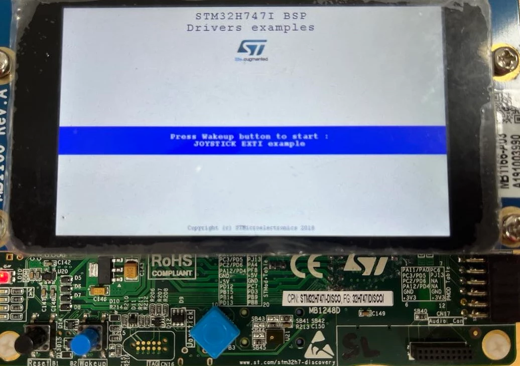

Hello;
I have the STM32H747I-DISCO card CPN: STM32H747I-DISCO, FG: DK32H747/SAT1, and on the MB1166-A03 screen A225300631. The problem is when I try to test the card with the BSP example, I encounter the following problem:
I saw in the forums regarding this topic that an ST Employee suggests that the fix is available on GitHub:
https://github.com/STMicroelectronics/STM32CubeH7/commit/1c84713102f8509deb79ae14db8dbb104c17c45e#diff-8a5b12f7040dfb560c495dc0a1213725ba939bf19d531dd1e97067b6a1a79ec0
I tried replacing the files, but nothing is working, so please, I need an immediate solution.
best regards
Best answer by Kfell.1
I find the problem
the problem is the version of driver : the LCD FGRIDA FRD397B25009D-CTK replaced by  FGRIDA FRD400B25025A-CTK
thank you

mƎALLEm
September 11, 2023
1-  Was stm32_lcd.c already included in the project?:
2- Check the availability of stm32_lcd.c under the path \Utilities\lcd\stm32_lcd.c
mƎALLEm
September 12, 2023
@Pavel A. The project is under the path: Projects\STM32H747I-DISCO\Examples\BSP
The project is not available on github (strange) but in the STM32CubeH7 zip package.
@Kfell.1:
Sorry, at the beginning you posted a symptom of linking issue now you said that you are running the example with an issue in the LCD display.. I'm a bit confused!
I've just run the example and it worked fine from my side:
But there is another thread which I think it describes the same symptom as yours: https://community.st.com/t5/stm32-mcus-touch-gfx-and-gui/stm32f769i-disco-really-noisy-tft-lcd-display/td-p/55127
Kfell.1
Kfell.1AuthorBest answer
September 13, 2023
I find the problem
thank you
