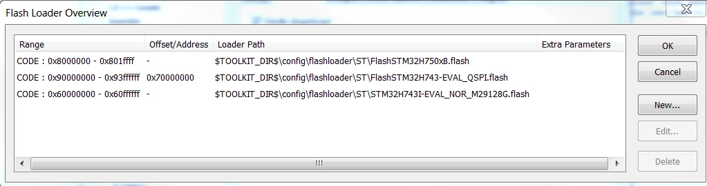

Khouloud GARSI
Oct 3, 2018 3:28 PM UTC
Hi @Community member​ ,
Using the project under EWARM IDE, could you please check the Flash loaders? You should make sure that at least the second one shown in the screenshot below is available.
I have tested the application from my side and it's working conveniently: Using EWARM, in order to load the project image from the IDE, "Project-> Download and Debug" is all what you should do.
Khouloud.
Asantos
AsantosAuthor
Oct 3, 2018 6:52 PM UTC
IAR support told me to update the EWARM to the version 8.30.2 to have this flashloader. :smiling_face_with_smiling_eyes: Now I can download the code to the quad-spi flash using the command project->debug.
