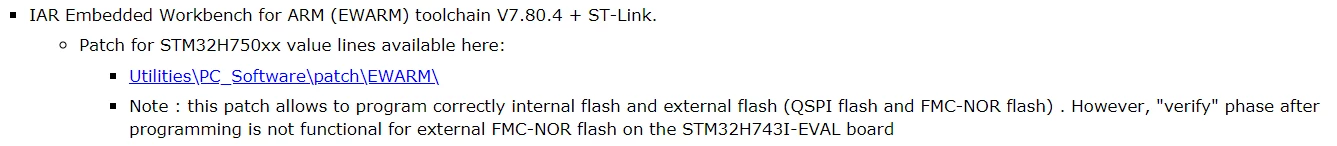

I'm trying to load the LedToggling applicaton into the STM32H743I-EVAL board compiled with the XIP_QSPI_InternalSRAM configuration and using the EWARM.
It is written in the readme.txt file that for the EWARM I only have to use is Project->Debug. But the debugger return errors trying to program the address 0x9000000.
Using the ST-LINK Utility v4.2.0 I can program and run the application. So the hardware is Ok.
Is it really possible to load the code into the quad-spi using the EWARM debugger directly?
Ari.

Hi @Community member​ ,
  • Glad to know that the issue is solved :smiling_face_with_smiling_eyes:
  • Just for your information, if you want to use an older version of EWARM IDE, you have to apply the patch provided under STM32H7Cube package under the path below:
Repository\STM32Cube_FW_H7_V1.3.0\Utilities\PC_Software\patch\EWARM
This was mentioned in the release note:
  • If you have any other questions, please do not hesitate to post them in our STM32 MCUs forum.
