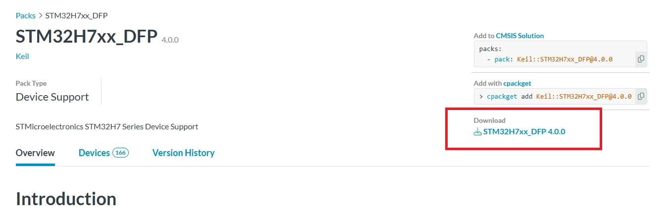

STM32H74: 'error loading software packs run-time environment'
How to solve this error 'error loading software packs run-time environment might work incorrectiy see build output for details' when using STM32H745?
Thank you!
Harry_WanBest answer
November 20, 2024
Thank you all for reply.
I use KEIL and had already installed H7 pack. I have solved this problem by reinstalling KEIL and related packs.
I think there maybe some files damaged during operation.

Hello @Harry_Wan and welcome to the community,
To increase the probably of obtaining a answer, could you please share your project and more details about "build output"?
Thank you.
Kaouthar
Andrew Neil
November 19, 2024
So did you do that?
A bit more detail there would help: what exactly were you doing? What were the steps to get to this situation?
Is this in STM32CubeIDE?
Tesla DeLorean
Guru
November 19, 2024
Sounds like KEIL/MDK
What Version? What version of H7 Pack?
mƎALLEm
November 19, 2024
If KEIL used, did you already installed the H7 pack? from: https://www.keil.arm.com/packs/stm32h7xx_dfp-keil/overview/
Harry_WanAuthorBest answer
November 20, 2024
