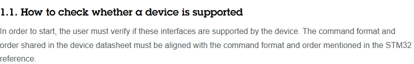

The command format and order shared in the device datasheet must be aligned with the command format and order mentioned in the STM32 reference.

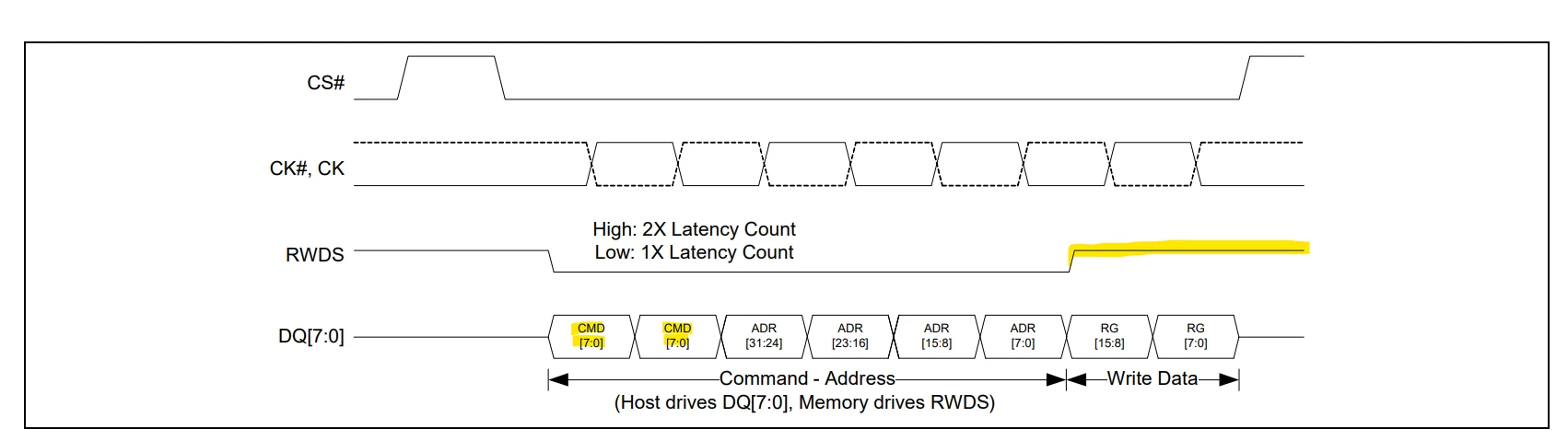

I noted in S70KL1283 memory datasheet that:
- Each transaction has a 16-bit command which selects the type of device operation to perform. The 16-bit command is based on two 8-bit opcodes. The same 8-bit opcode is sent on both edges of the clock.

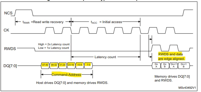

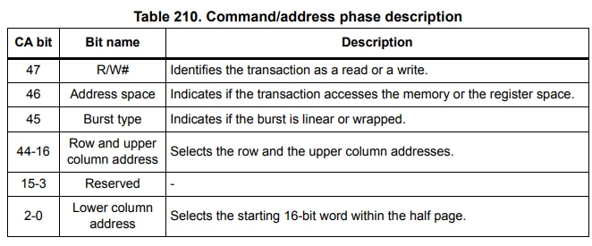

But the format supported by the OCTOSPI interface with the HyperBus protocol, as mentioned in the reference manual, is
For that, the user must verify if these interfaces are supported by the device. I recommend you to look this FAQ may help you to start with the OCTOSPI interface.

Hello Kaouthar,
thank you for your answer.
As I understood, you have the same conclusion as me that our current RAM device is not compatible with the STM32H7 OCTOSPI.
We will replace the RAM devices on our existing PCBs with a device that is supporting HYPERBUS. Then it should work as expected.
