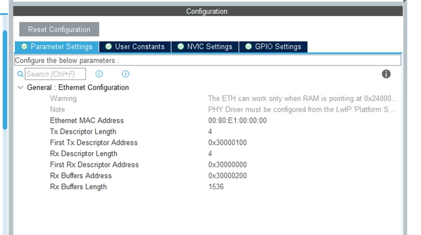

STM32H735 with Ethernet & LAN8710A PHY
Hello
I am triyng to use STM32H735 with ethernet (ln8710A is the PHY)
We have hardware fault when we connect the cable (se the itm print below)
We use CubeMx version Version: 1.18.0
ETH is in RMII conection is OK

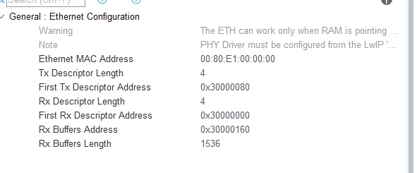

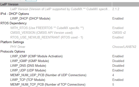

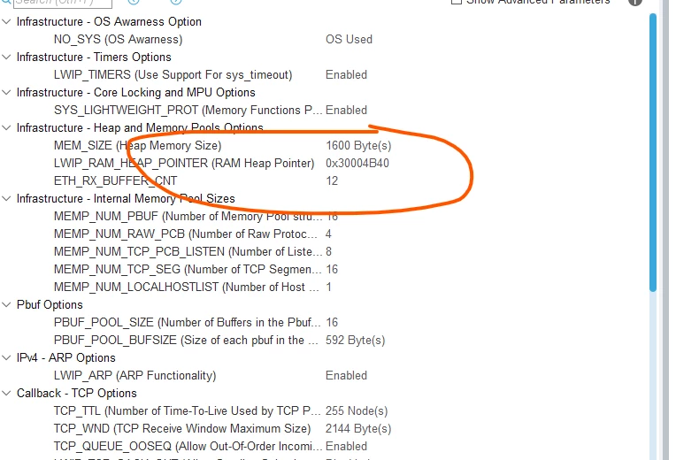

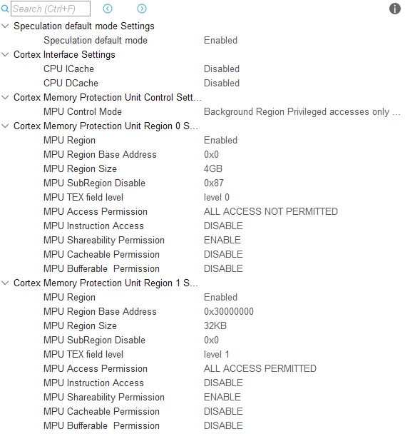

the hardware is good
we have test many configurations for memory position for Rx Tx and LwiRamHeap
In certain conditions hi dont remember its , I succeeded to ping my board , but
after several try of ping we have hardware fault
We think that it was bad configuration for Rx Tx and the heap description .
Can you help me to fit the good comfiguration

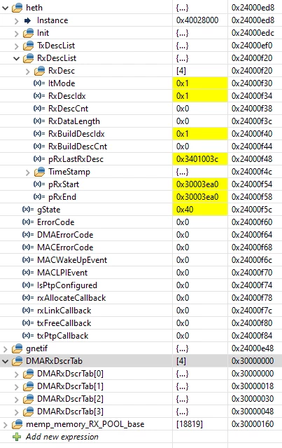

Now the stack is running
When we try to ping the board the response is OK
C:\Users>ping 192.0.1.218 -t
Envoi d’une requête 'Ping' 192.0.1.218 avec 32 octets de données :
Réponse de 192.0.1.218 : octets=32 temps<1ms TTL=255
but we have DMAErrorCode=0x4080 ? why ?

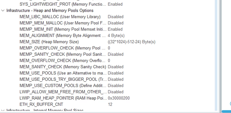

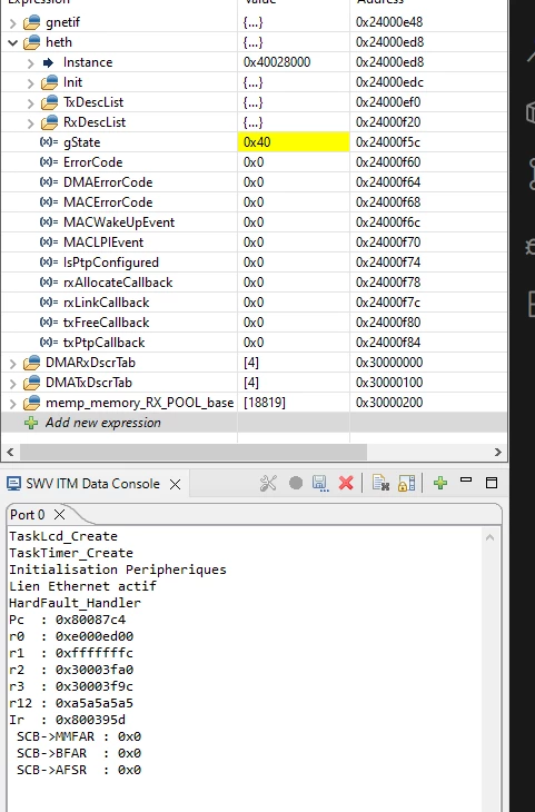

Hello
I’m using an STM32H735VGT6 with the PHY LAN8710, the hardware of the board is working.
I managed to generate a ping to the IP address: 182.00.01.228.
the configuration was :
Ethernet :
Lwip
When we connect the cable hard fault :
Nota : this project have been worked one night whithout probleme ,We dont understand .
We have not modified anythink and then he dont work ???
Is some one have develop an ethernet project with the stm32h735...
Please help
