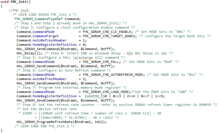

I'm trying to run SDRAM (AS4C4M16SA-5TCN) with FMC. It looks like all connections are correct. When I try to read/write to memory pointer, I got memory management fault handler.

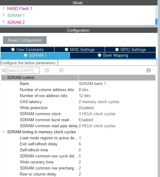

My FMC configuration:
Clock connected to FMC is 275MHz (HCLK3). I've tried also to lower it to ~30MHz, but it didn't help.
Under "USER CODE BEGIN 2" I'm executing FMC_Init() function. This is it:
I tried to write something to memory, but this is the moment when fault handler is activated:
*(__IO uint8_t*) (SDRAM_START_ADDR) = 0x00;
SDRAM_START_ADDR is defined as 0xC0000000.
All FMC's GPIOs are set to Very High speed. What else can I check?

Do you have the default MPU configuration activated to prevent the CM7 speculative access in your project? like this:
 MPU_InitStruct.Enable = MPU_REGION_ENABLE;
 MPU_InitStruct.BaseAddress = 0x00;
 MPU_InitStruct.Size = MPU_REGION_SIZE_4GB;
 MPU_InitStruct.AccessPermission = MPU_REGION_NO_ACCESS;
 MPU_InitStruct.IsBufferable = MPU_ACCESS_NOT_BUFFERABLE;
 MPU_InitStruct.IsCacheable = MPU_ACCESS_NOT_CACHEABLE;
 MPU_InitStruct.IsShareable = MPU_ACCESS_SHAREABLE;
 MPU_InitStruct.Number = MPU_REGION_NUMBER0;
 MPU_InitStruct.TypeExtField = MPU_TEX_LEVEL0;
 MPU_InitStruct.SubRegionDisable = 0x87;
 MPU_InitStruct.DisableExec = MPU_INSTRUCTION_ACCESS_DISABLE;
That MPU configuration prevents any access to any external memory. See this thread for the explanation.
You need to add another MPU region to activate the access to you SDRAM memory region.
This is an example of the FMC_SDRAM provided by the H7 CubeHAL. There is a default MPU config and there is a second one to activate the access to the SDRAM:

 Hope that helps.
