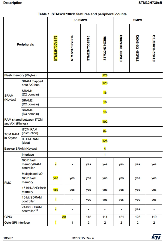

We have a custom board prototype with a STM32H730VBT6 (LQFP100 package) and a SPI NOR flash memory.
Sadly, this not connected to the OCTOSPIM_P1 port, but to the SPI1_NSS, SPI1_SCK, SPI1_MISO, SPI1_MISO (PA4, PA5, PA6, PB5) port (so, ony 2 data lines are connected, classic SPI).
Now, our application will not fit into internal flash (nor into RAM), so we are captive to use external memory for our program. How can we solve it, except make a new board? Some questions more in detail:
1. Can SPI1 be mapped somehow to OCTOSPI1?
2. Is it (physically or software-wise) possible at all to use that SPI1 connected chip as memory?
    I'd probably would have to reprogram the whole memory protocol (command, address, alternate bytes and data phase...)?
3. What features are possible: DTR? Dual-line SPI? Memory-mapped mode?
    (I think, at least the latter is impossible, if the answer to 1. is no.)
4. Is it possible to execute-in-place from that memory?
    (I think not, if it cannot be brought into memory-mapped mode.)
Can You shed some light, and maybe also confirm or refute my assumptions?
Thank You very much!

Simple SPI flash (not QSPI/OSPI) does not work in memory mapped mode. Not possible to run XIP code from there.
But H730 has large RAM. Can you divide the code to overlays, store them in the flash and copy the parts into RAM to execute? Be creative.

The idea to execute codeparts from RAM I had too. That's the "BootROM support" of AN5188, in opposite to the "Execute in place (XiP) support", right?
What "large" RAM do You mean? ;) This is the information I have from the Datasheet:
With this the code will probably not fit into memory, not even with all memory summed up - just an estimation. We plan several UART-based protocols, and several Ethernet-based protocols. Especially the latter I see producing quite a large code. Any opposite estimations?
So, I end up with quite some software-side effort to manage the memory and the shoveling? It's no blocker, but I must take that into conideration.
More than 128 KB ))

I'm using a large UART debug protocol file, have ethernet with lwip, http server, and current flash use is at 350 kB.
pkoevesdiAuthor
Mar 28, 2024 12:39 PM UTC
I know, a display is planned too, I'm not sure about pictures on there.
I made a small test bringung up ethernet (from a rust example), and it went already above 128 KiB. That's where I took my assumption, that the whole thing will not fit. But thanks for the "counter estimation", that You got stuff running at 350 KiB. Still, also this already would take some efforts to get the code from the external flash into several RAM banks. (I haven't dealt with this yet.)

No chance on using SPI in any other form than classic SPI (no XIP, no 2 Bit mode etc), apert from copy Your code to RAM and execute it in RAM, You could switch to the pin compatible STM32H725/735 chip, so You have up to 1MByte of internal Flash.
