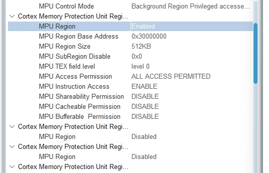

[STM32H7] When I set the MPU at the address 0x30000000,Program entry HardFault
The configuration of Cubemx is as follows
The configured address is the address of SRAM1-3,given this configuration, why does "Strongly ordered memory" cause a HardFault
Thanks.

PasserbyAuthor
March 6, 2024
Hello,@Sarra.S
But it works when I set it to "TEX = 1   C = 0  B = 0  S = 0", shareability is disable,Why?
When I set it to  "TEX = 0   C = 0  B = 0  S = 1",it is cannot work。
Thanks.

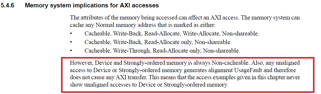

March 6, 2024
Are you doing an Unaligned access to that memory region?
See: https://www.keil.com/support/docs/3777%20%20.htm
From ARM CM7 TRM:

mƎALLEm
mƎALLEmBest answer
March 6, 2024
I don't know about LWIP, but you can check if you faced an unaligned access in your application by reading SCB_CFSR register:
If SCB_CFSR = 0x01000000 -> you have an unaligned access.
For your reference: https://developer.arm.com/documentation/dui0646/c/Cortex-M7-Peripherals/System-control-block/Configurable-Fault-Status-Register?lang=en#Cihgbdbi
