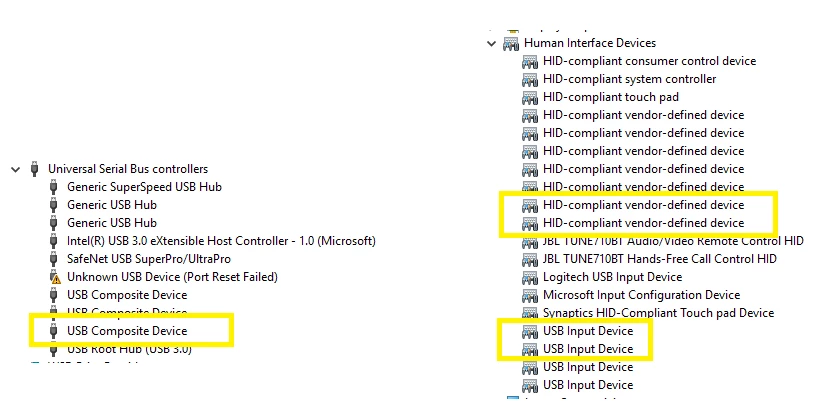

I followed the examples in STM32CubeH7 package and implemented USB Custom HID device with 1 interface. The device is working fine. Now, I want to implement USB Custom HID Device with two interfaces. I want my device to be listed as highlighted in attached image.

What I understood from the post is, for the 2nd interface add the following in USBD_CUSTOM_HID_CfgDesc in usbd_customhid.c
  • Descriptors needs to be changed to indicate composite device. bNumInterfaces set to 2
  • Add Descriptor of CUSTOM HID interface
  • Add Descriptor of CUSTOM_HID
  • Add Descriptor of Custom HID endpoints
Questions:
  • What should be the EPIN/EPOUT address. Shall I use 2nd endpoint?e 0x82(EPIN) and 0x02(EPOUT)
  • How to receive data from 2nd interface? CustomHID_OutEvent()
  • Should I register callback for 2nd interface in USBD_CUSTOM_HID_RegisterInterface()? If so how to handle USBD handle members classId, NumClasses?
  • What is the purpose of the macro USE_USBD_COMPOSITE in library? Should I have to define USE_USBD_COMPOSITE in my case
  • Should I have to use CompositeBuilder class. Any example on how to build.
Greatly appreciate any help on this.
Thanks!
