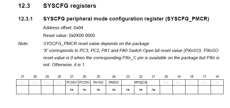

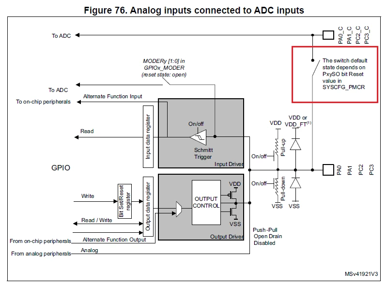

How did you configure the internal switches?
They need to be closed. So their respective values of PCXSO in SYSCFG_PMCR register needs to be 0.
+ Read this article: https://community.st.com/t5/stm32-mcus/faq-default-state-of-stm32h7-switches-connecting-pxy-c-and-pxy/ta-p/49300

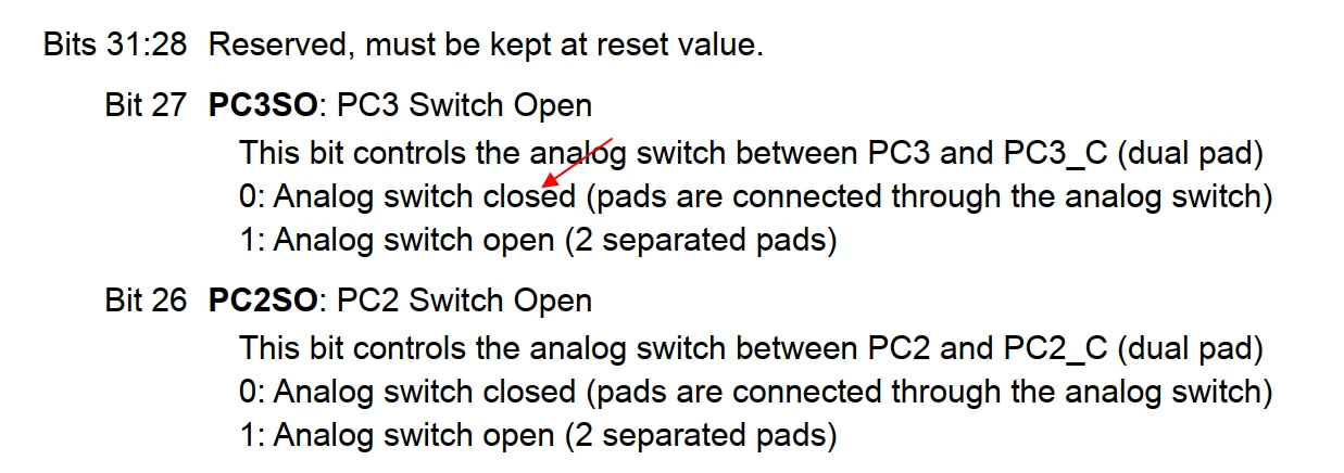

it seems i misled by the H755 user manual.
please check H755 rm0399, page 587
it states 0 is close, actually 1 is close.

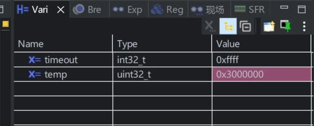

I read PMCR, 0x300 0000, and PC2, PC3 GPIO function is normal now.
0 is default register value from reset, but GPIO is not working.

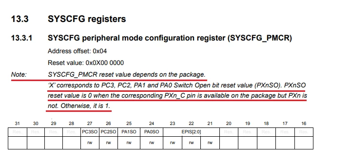

The default status of the switches depends on the package:
Also, read this article: https://community.st.com/t5/stm32-mcus/faq-default-state-of-stm32h7-switches-connecting-pxy-c-and-pxy/ta-p/49300
