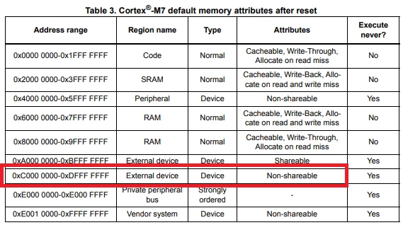

Hi All,
I was testing my new STM32H746XIH6 board and met the post below by @GSpre.1 during a search about SDRAM  performance.
GSpre.1 - Performance characteristics of SDRAM on STM32F7508-DISCO board
I don't have a lot of time to read MPU documentation, maybe someone has an idea about the code piece below that @GSpre.1  adviced.
I did not perform a precise measurement but used Systick for both internal and external (32-bit SDRAM) memory array manipulation time for the same data length. (I-Cache and D-Cache are both enabled as expected.)
Internal memory test:  12ms
External memory test: 47ms without the code below
External memory test: 13ms.with the code below
* What exactly the code below does ?
* Am I compromising from anything for speed ?
There are a lot of job to do during board bring-up I have no time to read a lot of documentation. I will be appreciated if someone share experience...
BTW, thanks for sharing @GSpre.1
Regars.
 MPU_Region_InitTypeDef MPU_InitStruct;
 HAL_MPU_Disable();
 MPU_InitStruct.Enable = MPU_REGION_ENABLE;
 MPU_InitStruct.BaseAddress = 0xD0000000;
 MPU_InitStruct.Size = MPU_REGION_SIZE_32MB;
 MPU_InitStruct.AccessPermission = MPU_REGION_FULL_ACCESS;
 MPU_InitStruct.IsBufferable = MPU_ACCESS_BUFFERABLE;
 MPU_InitStruct.IsCacheable = MPU_ACCESS_CACHEABLE;
 MPU_InitStruct.IsShareable = MPU_ACCESS_NOT_SHAREABLE;
 MPU_InitStruct.Number = MPU_REGION_NUMBER0;
 MPU_InitStruct.TypeExtField = MPU_TEX_LEVEL1;
 MPU_InitStruct.SubRegionDisable = 0x00;
 MPU_InitStruct.DisableExec = MPU_INSTRUCTION_ACCESS_DISABLE;
 HAL_MPU_ConfigRegion(&MPU_InitStruct);
 HAL_MPU_Enable(MPU_PRIVILEGED_DEFAULT);

The address 0xDXXX XXXX is not a cacheable region by default. Device means not cacheable even the caches are enabled (data and instruction).
The code you shared makes the 0xDXXX XXXX region cacheable.
So the results you shared are expected.
Hope that helps
