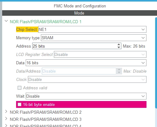

My concern is about the FMC on the STM32H7.
I want to read/write a 16bits device.
Currently I'm using this configuration (almost the default one) :
My code for testing a write operation :

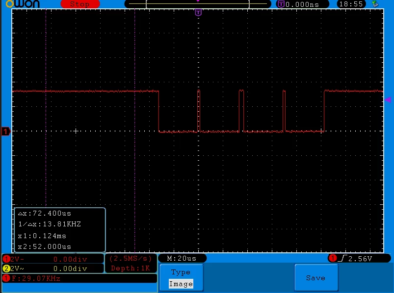

I can't see any problem in the code but when I check signals with an oscilloscope, I can see that the CPU is issuing 4 consecutive write operation :
A0 / A1 are also increasing as if the CPU is writing to 4 different places.
How can it be possible.

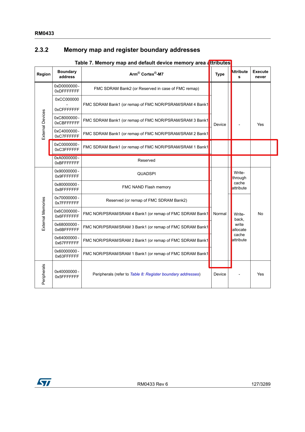

Currently, I manage to make it work but it's not the way I thought.
I had to change the bank address to 0xC0000000
and deactivate MPU.
I can see one write cycle and my device is now working as expected.
But I'm not sure it's a good idea to deactivate the MPU.
I later found this related thread :
https://community.st.com/t5/stm32-mcus-touchgfx-and-gui/stm32h743ii-fmc-8080-lcd-spurious-writes/td-p/354191
By the way, it's sad that cubeide didn't warm you about the bank remapping needed in 16 bits mode needed for sram/nor/lcd..

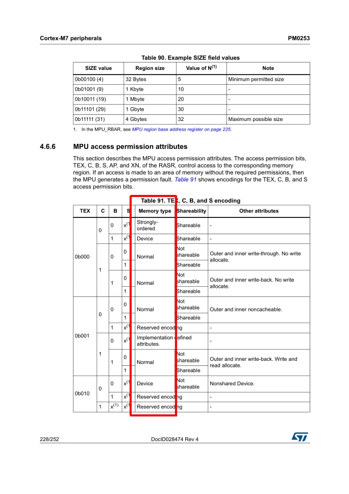

While waiting for better answers, can you do another quick experiment?
Using the MPU disable caching on your external memory window.
Per AN4839, the 0x60000000-0x7FFFFFFF range on STM32H7 is "normal memory", cacheable. What you see could be loading the 32-byte cache line and write back.
Also, check the suitable memory mode for FMC: should it be "SRAM" or other?

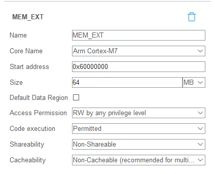

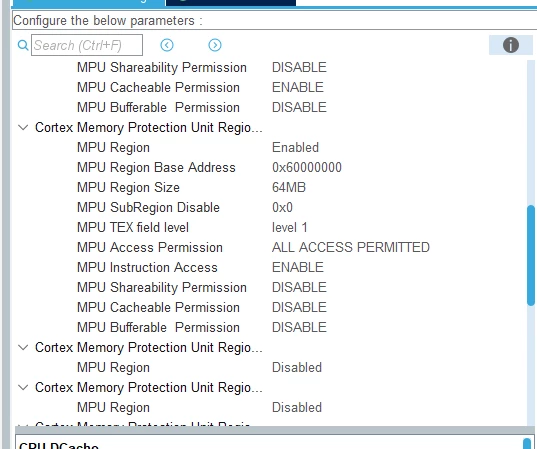

Alex_JAuthor
June 17, 2025
@Pavel A.
Thanks for your answer, but currently, caching is disable for this region :
How do you know those are *write* operations? Which signal do you display there?
Do you have that area set as Device or as Memory in MPU?
Alex_JAuthor
June 17, 2025
I'm sorry that I forgot to mention that the signal shown is the WE send from the STM32 to the device.

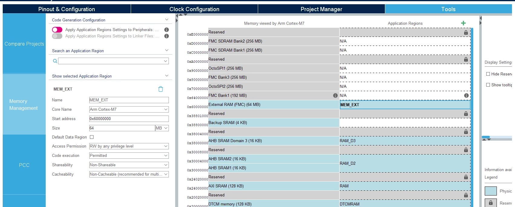

Do you have the used FMC memory area set as Device or as Memory in MPU?
Alex_JAuthor
June 18, 2025
@waclawek.jan
Either I don't know where to search for this option, either it did not exist xD :
Edit :
I also try to deactivate the MPU without success, I still have 4 write cycle.

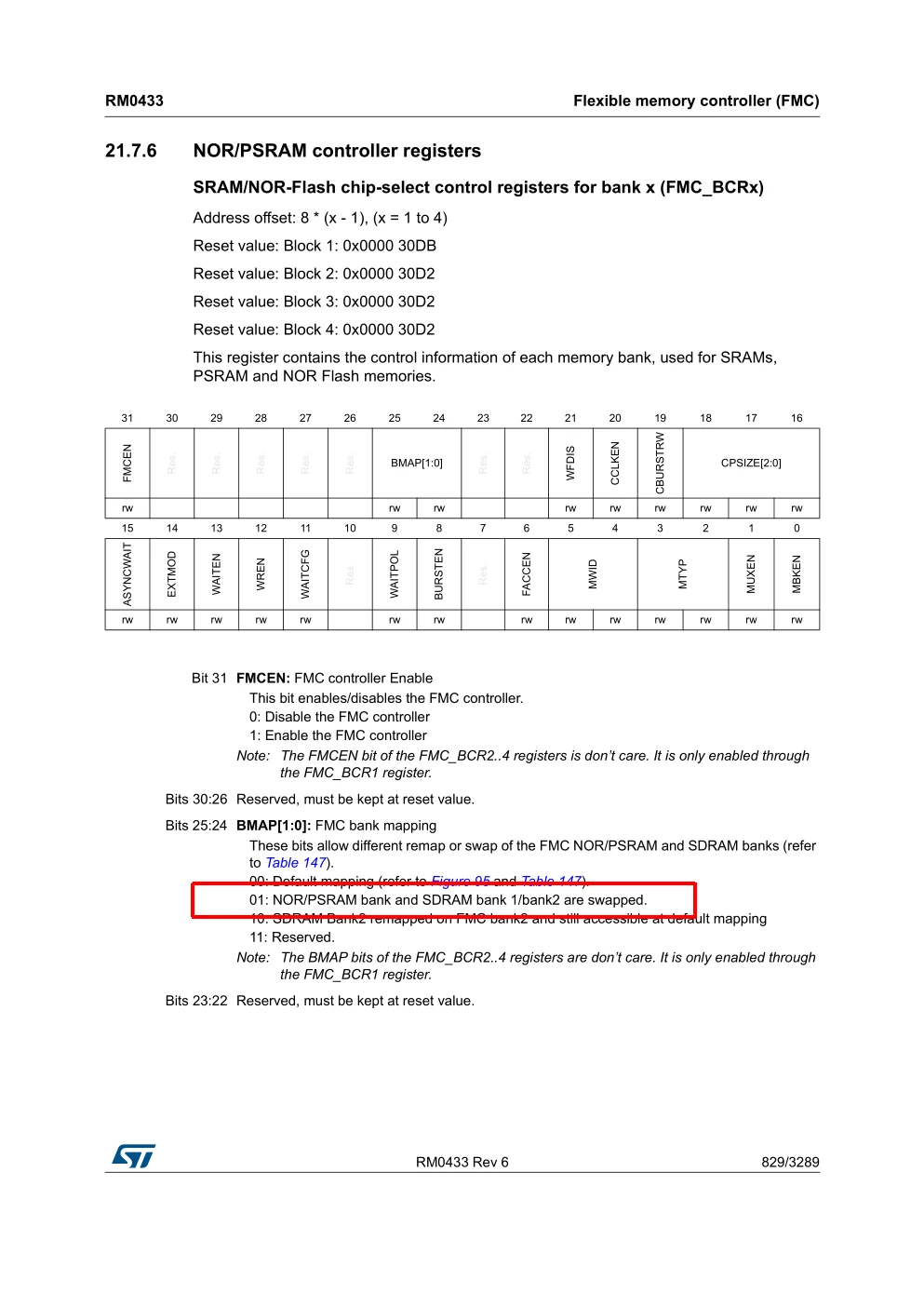

I don't know which 'H7 you are using, so I looked into RM0433 (for 'H743 and kin) and there's an option to remap the SRAM/NOR area of FMC to a different address, which is by default set to Device:
The remap in the 'H743 is accomplished through setting the FMC_BCR1.BMAP bitfield
However, if you apply MPU settings onto a memory area, its those MPU settings which override the defaults, so here you would perhaps want to do only the remap without using MPU at all.
Again, I have no idea how is this clicked in CubeMX.
And still, this is just one thing to try, I don't say this will certainly solve your problem. The Cortex-M7 is an overcomplicated beast and the 'H7 in particular adds a couple of extra layers of complexities to it.
