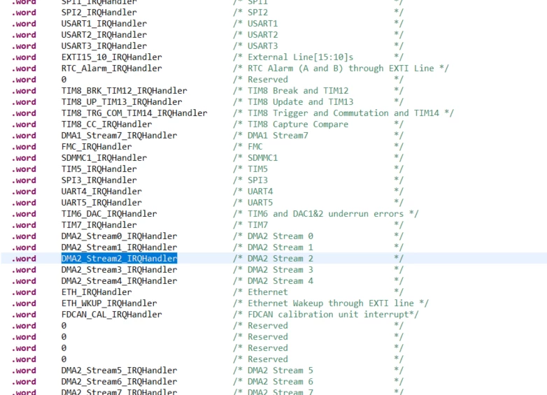

Pavel A.
March 6, 2021
Is a function DMA2_Stream2_IRQHandler implemented somewhere? This is your handler.
This name must be exactly same as defined in your startup_stm32h743xx.s

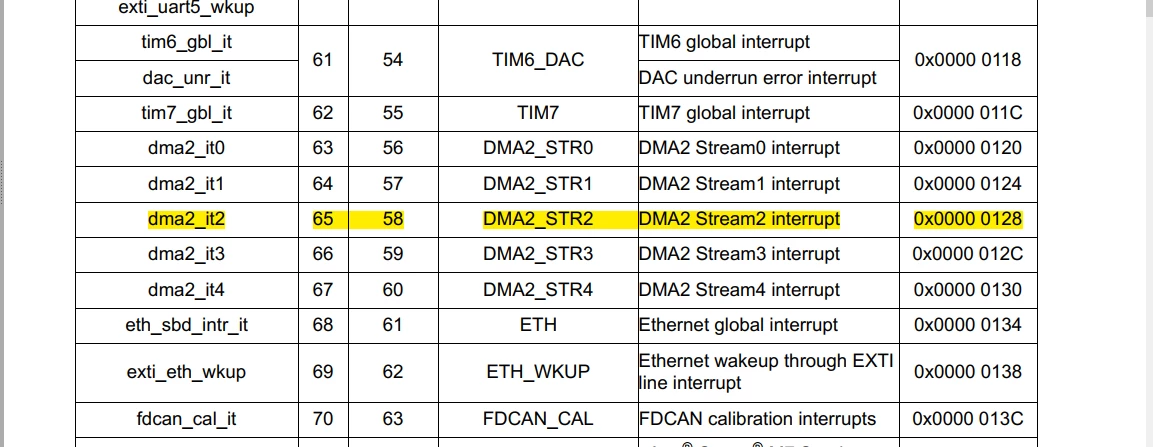

Update I also checked NVIC ISER and NVIC->ISER[1]=0x400 0000 which means the bit 58 is 1, it is DMA2 Stream2 interrupt

@Pavel A.​
In my startup_stm32h743xx.s, DMA2_Stream2_IRQHandler is registered here :
0693W000008wGPPQA2.pngAnd in "stm32h7xx_it.c" :
void DMA2_Stream2_IRQHandler(void)
 HAL_DMA_IRQHandler(&hdma_spi1_rx);

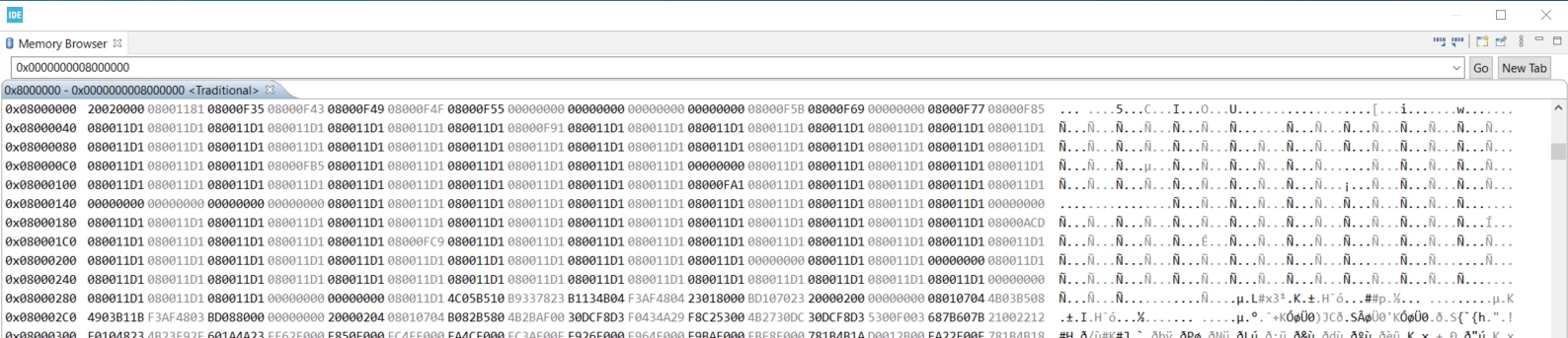

I know the interrupt doesnt fire because I put a breakpoint in DMA2_Stream2_IRQHandler()
Also, you think I shouldn't enable SPI1 interrupts ? Does the SPI throw an End of Tranfert interrupt when DMA is done or when it starts transfering ?
From looking at map file, DMA2_Stream2_IRQHandler address is 0x0000000008000fa0
With memory browser, I see a 08000FA1 value at 0x8000128 address.
0693W000008wGWLQA2.pngIt is the correct position and value (good news but bad news for diagnostic)
0693W000008wGotQAE.pngAlso I checked and SCB->VTOR = 0x8000000

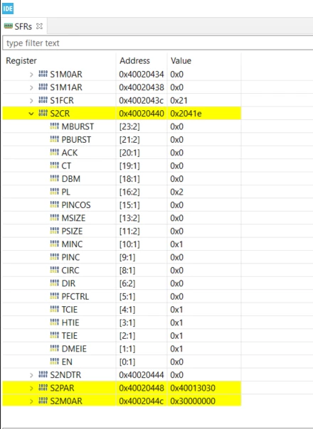

You've already checked that the HT and TC flags are set in the DMA status register, but are the HT and TC interrupts enabled locally, i.e. in respective DMA stream's control register?

Yes, DMA2 Stream 2 configuration register gets set in HAL_SPI_Receive_DMA function
Here is register :
