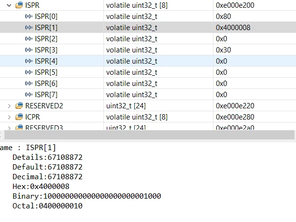

STM32H7 DMA2 wont trigger interrupt
Using STM32H743ZI
I am using SPI1 in 2 lines Rx only mode with DMA2 Stream 2 as in ST example
I use Rx DMA with a buffer located in D2 RAM. Using debugger I found that the first reception works well, data gets written into my buffer. But my DMA doesn't fire any interrupt, so the next transfers do not work.

NVIC Pending register after first Rx : The bit 35 is 1 (SP1) and the bit 58 is 1 (DMA2 Stream 2), but my breakpoints in both Handler aren't triggered (I will try GPIO debug)
0693W000008wHVOQA2.pngFor priority, I registered my interrupts at level 0 or 1 (highest) because in my application SPI1 Rx is the most critical process
waclawek.jan
Mar 8, 2021 1:32 PM UTC
Maybe interrupts are globally disabled.
This is in PRIMASK, which is a processor internal register, I don't know if and how your debugger can display it.
Also, you may be inside an interrupt of the same or higher priority. Check IPSR (again, a processor internal register).
You can also have a look at the SCB_ICSR register, that should contain the currently executed interrupt number (or 0 if no interrupt), too.

Here is my EXTI callback that starts a SPI Rx, I added two variable to get PRIMASK and IPSR
void HAL_GPIO_EXTI_Callback(uint16_t GPIO_Pin)
	ADS1x9x_csn_0_en();
	uint32_t res = __get_PRIMASK();
	uint32_t res2 = __get_IPSR();
	HAL_SPI_Receive_DMA(&hspi1, ads_buf2, READBACK_LENGTH);
I read this :
PRIMASK = 0
IPSR = 0x17
SCB->ICSR = 0x400817 But I know I am in EXTI interrupt
The EXTI triggers at 4kHz and I am supposed to SPI1 Rx each trigger
EDIT : When I remove my breakpoint in EXTI callback I get into HAL_DMA_IRQHandler

My interrupts are working now, I added some flag clearing bare metal programming and removed breakpoints and it works now thanks !
