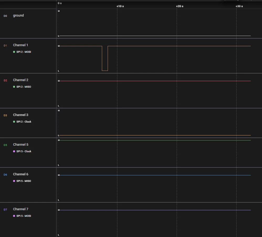

I initially used SPI5, however it wouldn’t transmit anything and its clock was always high.
Then I switched to using SPI2, however it was always stuck low.
Any insight would be appreciated.
I connected a logic analyzer and here is an image of this :

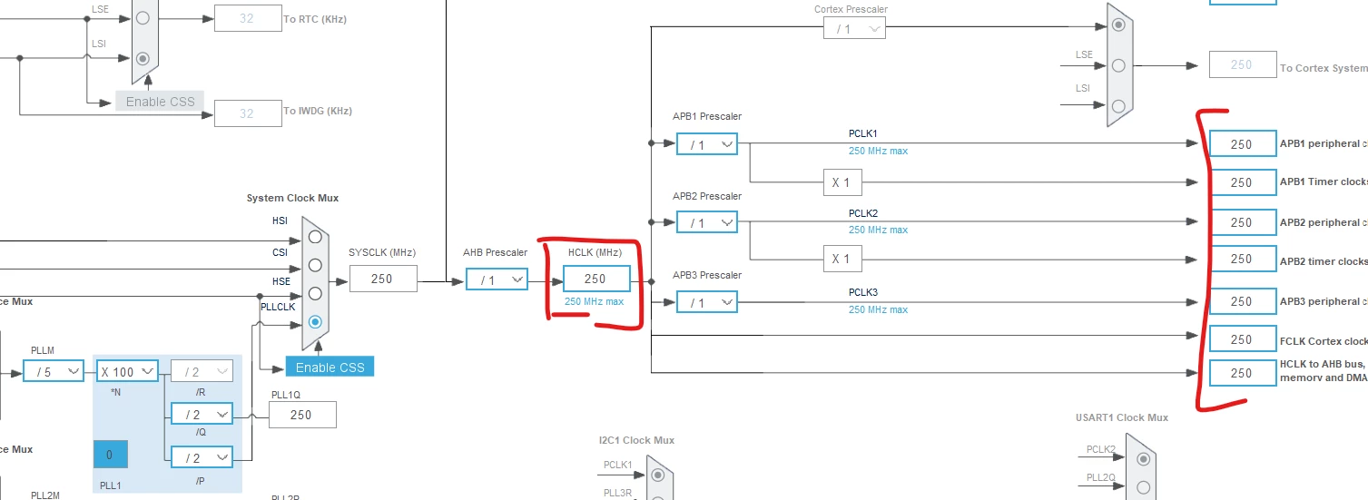

  • the system clock is set to max by default 250MHz
  • The peripheral clock is set to the max by default as well of 250MHz

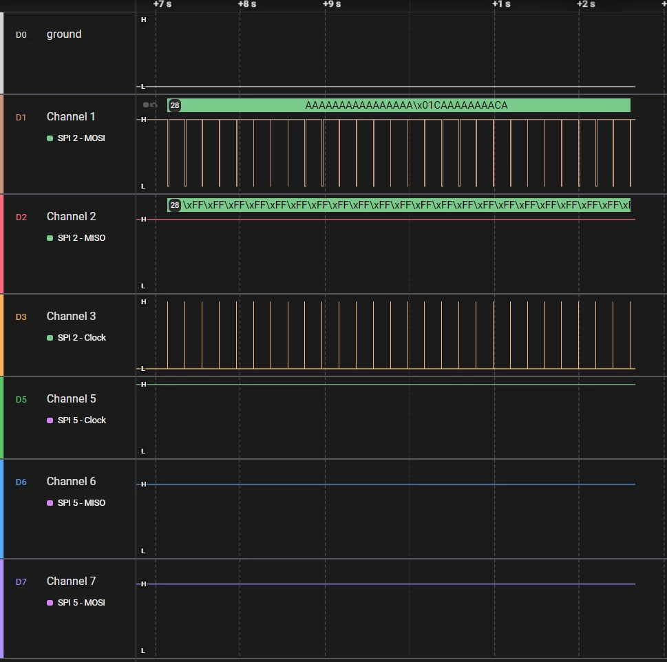

    • would like to note that C is detected in the image below which is not expected (I will need to check if this is due to also using SPI5).
  • In the same project I tried to setup spi5, however regardless of the prescaler value nothing would transmit over the lines.
  • An image of the output for both spi2 and spi5:

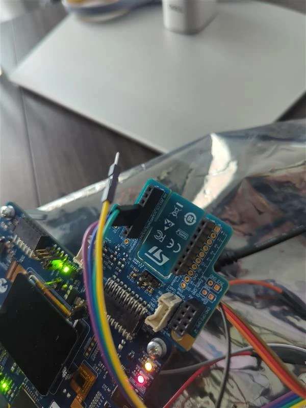

Original situation: I have the logic analyzer connected to the devkit and I am using the stmod+ extension. Image added at the bottom.

      • The pins weren't being used by another component and were free to use. Will note that the SPI5 pins had an extension/fan-out board to easily connect.

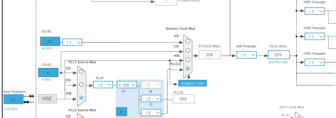

Currently I'm using the default configs for the clock:

Make sure Clock speed is 250MHz and peripheral clock speed is 250MHz

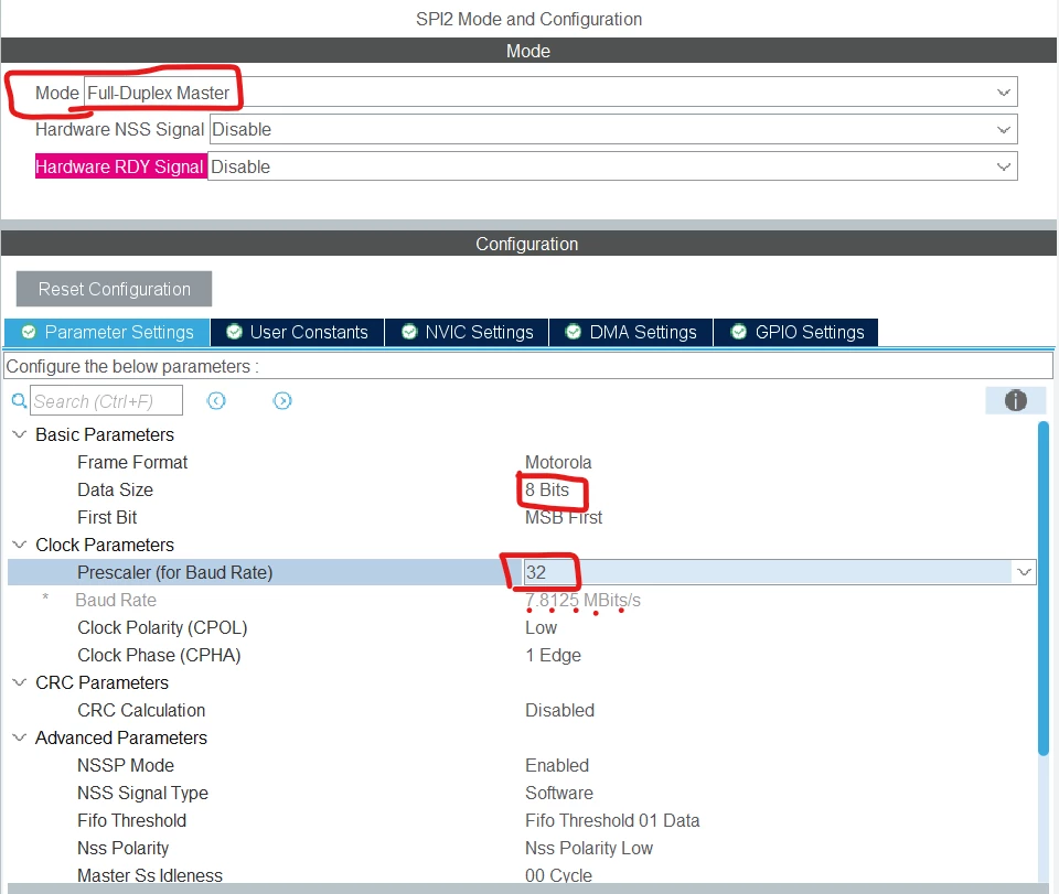

These are the configurations for SPI2: Mode Master full-duplex
  • set the datasize to 8 bits and prescaler to 32 to have a baudrate of 7.8125 MBits/s
