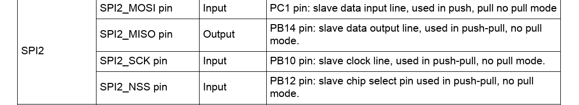

AScha.3
So the bootloader is started and sets PB14 as uartTX :
ed: as SPI2 output :
When you have flashed a valid program and dont start the bootloader, (boot0 = lo ),
but your program, PB14 will work as you want.
