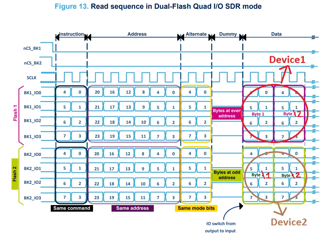

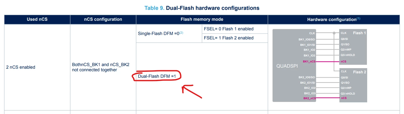

I've researched the topic a bit further and found Dual-Flash configuration in AN4760 (Figure 13 and Table 9).
I believe that Dual-Flash = (Dual-Single or Dual-Dual or Dual-Quad) SPI that can be selected in CubeMX.
Based on this forum post you've previously anwsered I have a following question:
Question2: What if we wanted to write to both devices simultaneously using Dual-Flash (Dual-Single) SPI configuration? (assuming that data buffers for devices 1 & 2 were interleaved ahead of time, e.g.: [Byte1Dev1] [Byte1Dev2] [Byte2Dev1] [Byte2Dev2] )
Question3: Is it possible to mirror SPI CLK signal on additional pin to eliminate star connection (trace split in two) on PCB?

Q3: no, it is not possible to bring out the same SCK signal also on a different pin (just one or the other). I do not know what would happen if you configure two different pins with the "same" ALT to provide the same SCK output (interesting trial). I assume, MCU will take the last pin you have configured via ALT as QSPI SCK out.
You could use QSPI in order to send - in parallel - to two different chips. But just Tx (only MOSI used), Rx is not possible.
Based on your schematics: you would run QSPI in 4-lane-mode (real QSPI): on DIOx (e.g. bit 0) goes to one chip, the other DIOx (e.g. bit 2) goes to another chip. Both chips are selected at the same time (via NSS).
But: there is just one register for the CMD, ADDR, ALT, DATA sent via QSPI. You had to place the bits for each chip on the right bit position in the data word sent. You do not have two separate registers for each chip, just one for both and you have to merge the different bits into one register word. (effort, but possible).
If you do not need to write both chips really in parallel - you can use TWO separate NSS signals: select one chip, send, select the other chip and send. NSS can be also a regular GPIO signal (and use SW control for NSS).
Just to clarify some terms for better understanding how this QSPI device works in MCU:
  • Single-SPI: it uses just DIO0 for MOSI (on a WRITE) and DIO1 as MISO (on a READ, not used here).
  • Dual-QSPI: it uses two QSPI chips:
    a) with two NSS signals, to select one or the other or both at the same time
    b) upper bits on OCTAL-SPI (DIO4..DIO7), so as an 8bit SPI
  • So, Single-SPI uses just MOSI and DIO0 in your case.
  • Dual-Single-SPI: I would assume: both as Single SPI (DIO0 only, maybe DIO1 for MISO, READ), but what about the NSS signal?
    a) not sure, if two NSS signals used now, are active at the same time (for a WRITE possible, but not for a READ)
    b) not sure, if now DIO4 is used also as Single-SPI but on the "upper" part (with two external chips), and just one NSS signal
Just configure the QSPI as you intent to use, use an oscilloscope and check if you get the signals as needed. Just to verify that the correct SPI transaction is generated (you do not need any external chip when doing just WRITEs).

a) two external chips written in sync, at the same time, but with different data (different MOSI)?
    One NSS selecting both at the same time?
b) two external chips, with Tx-only SPI (Master, Tx-only), but you can select one and then the other?
    (write both chips in a sequence)?
    Two NSS and selecting one or the other?
a) works only with DUAL or QUAD-SPI mode and bit-manipulations in the data register (and CMD, ADDR, ALT registers)
b) works on regular SPI, or on OCTAL-SPI in "Single-SPI" mode, but with two NSS signals (you might handle as SW GPIO NSS signals)
