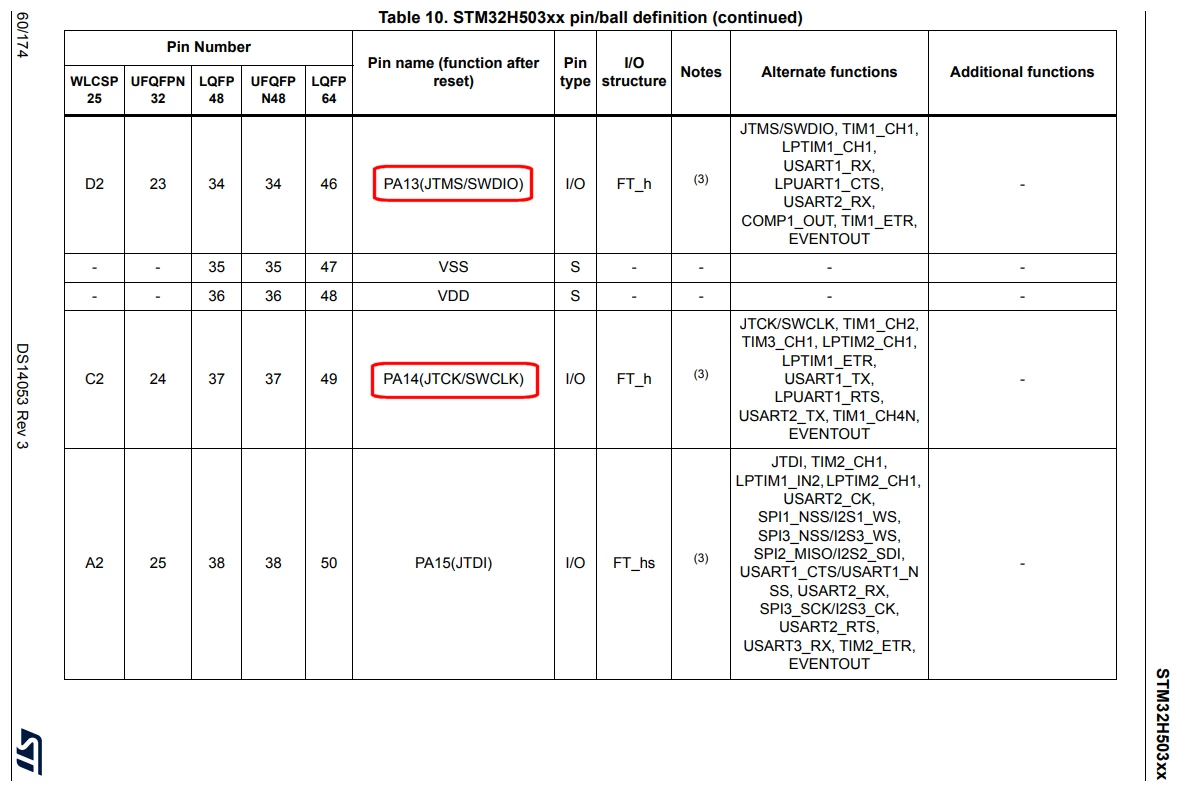

@Ravichandran wrote:
when configuring GPIOs in PORT A and integrating it with data pulses, the following error occurs stating the target device not responding.
The SWD Debug pins are on Port A:
Therefore, if your "configuring GPIOs in PORT A" includes PA13 and/or PA14, then that is going to break the debugger connection.

And you're sure you're not messing with PA13 and/or PA14 ?
Or doing any operations which affect the whole of Port-A?
As a test, what happens if you disable all use of Port-A ?
