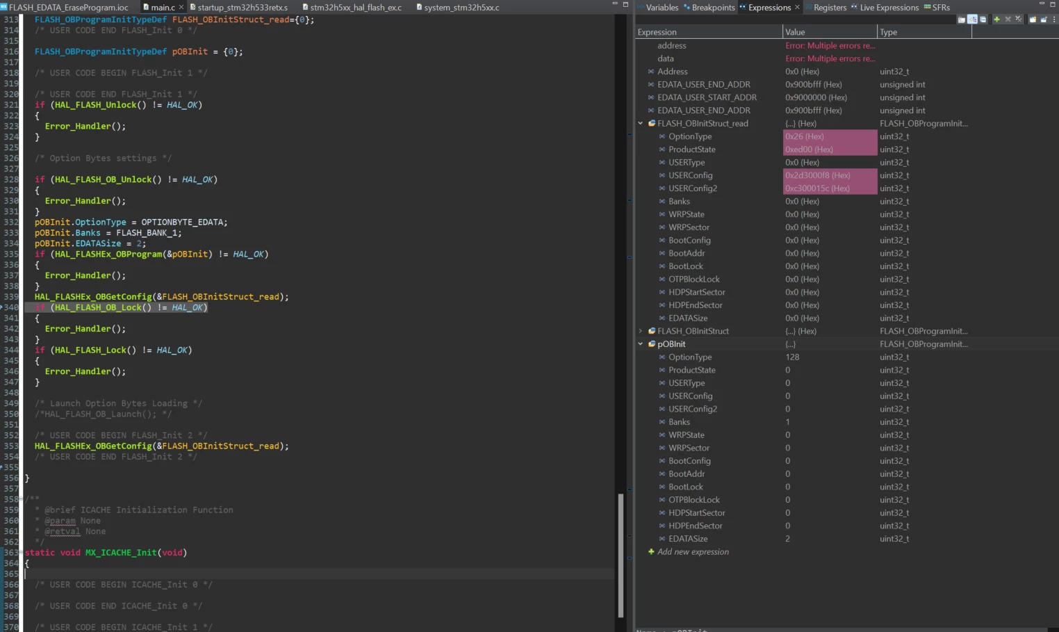

I’m using EDataBank_1 on an STM32 device to store user data after a power cycle. I based my code on the EraseProgram example and made these changes:
What I did:
  • Enabled FlashPeripheral and set EDataBank_1 size = 2
  • On first boot, I do:
    Init → Erase → Program → Read
  • After a reset, I do:
    Init → Read → (optional Program)
    (I skip erase to keep the data)
Problems:
  1. After writing, when I read back, I see userConfig is already set, which I didn’t expect.

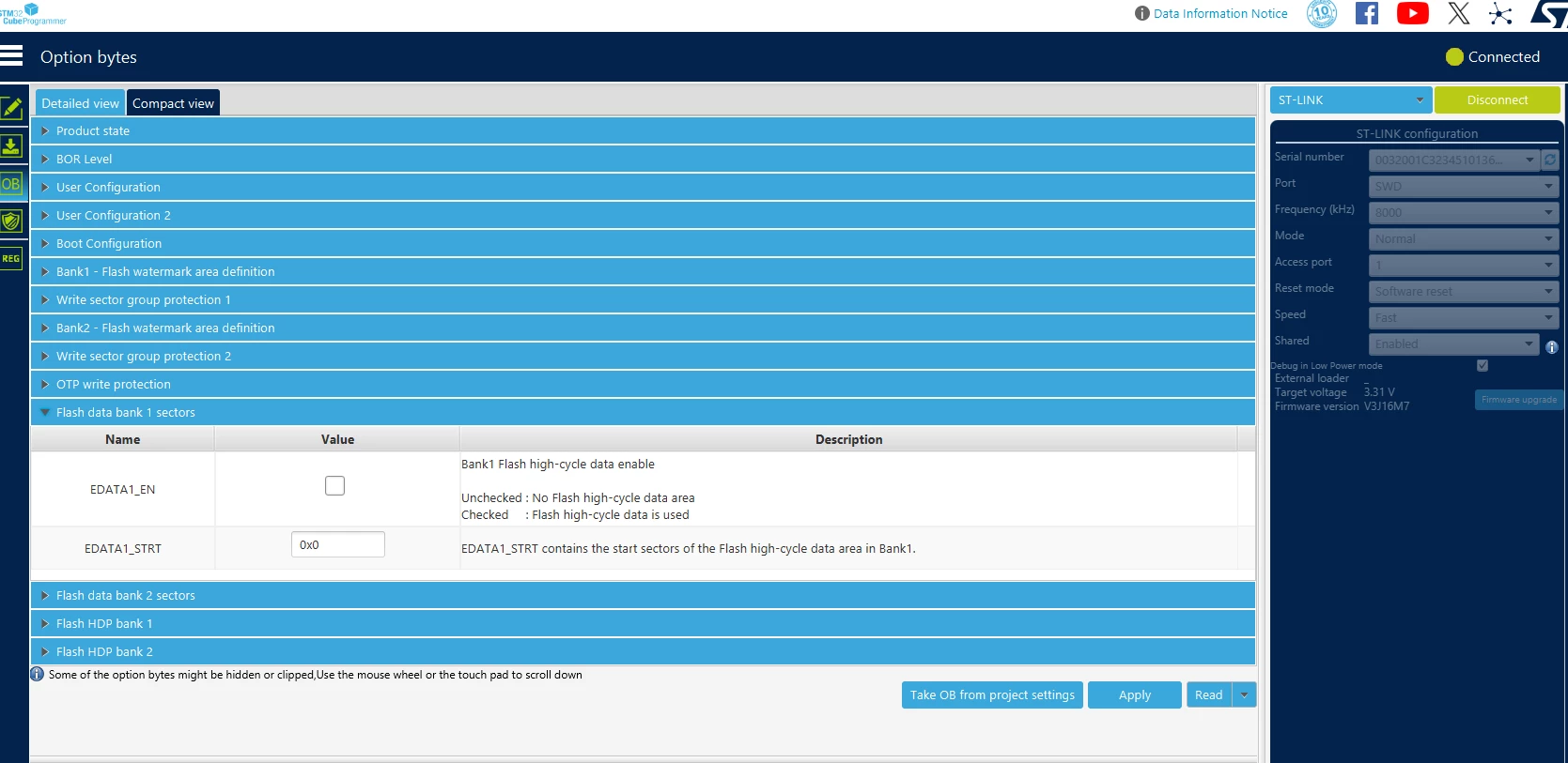

  2. I can’t read memory at 0x09000000 using STM32Programmer. It always gives a read error.
Questions:
  • Why does userConfig look configured right after a write?
  • How do I check if EDataBank_1 is still uninitialized (virgin) without erasing?
  • Is the read error at 0x09000000 due to write failure or ECC error?
  • How can I detect write errors or ECC issues?
Goal:
  • Save data once
  • Read/write it later without erase
  • Keep data even after power off
Any help is appreciated. Thanks!

Hello @mani9989,
You can check this article for ECC errors: Handling ECC errors in STM32H5 series: Reading unwritten OTP and flash data area
Also, check this application note: AN5342, section 3.2: Dealing with ECC errors in flash memory
