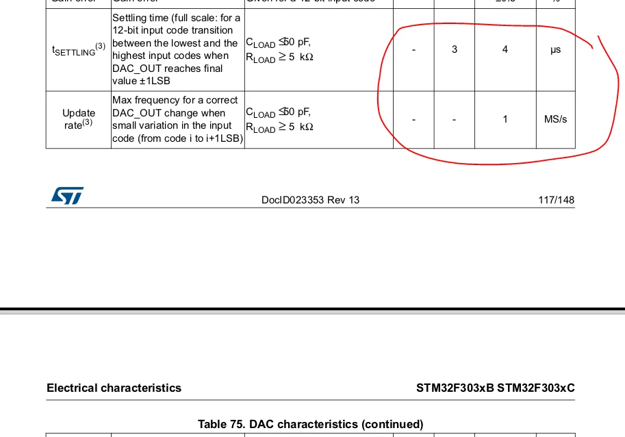

> What is with the DAC? AN4566 says the adc of the G4 series goes up to ~30MSPS but the datasheet only states 1MSPS for external connection?
You need to look at the datasheet of your MCU.
Here the relevant section for the STM32F303:
The settling time, which is caused by internal RC elements, will limit the effective signal bandwidth.
But even if you don't do "full swings" (for which this settling time is defined), I think output signals 1MHz or greater are not really achievable.
