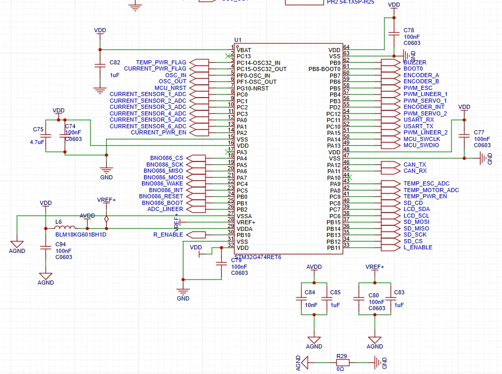

I designed a board around the STM32G474 and I'm trying to use an external 24 MHz HSE crystal, but the crystal won't run under any configuration — the generated SystemClock_Config() call to HAL_RCC_OscConfig() returns HAL_ERROR and I land straight in Error_Handler() (infinite while(1) loop).

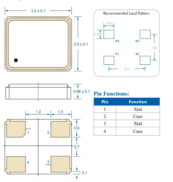

Crystal I'm using:
  • Manufacturer: Diodes Incorporated
  • Part Number: FL2400159
  • Frequency: 24.0000 MHz
  • Package: 3.2 x 2.5 mm, 4-pad ceramic SMD (Saronix-eCera FL series)
  • Load Capacitance (CL): 18 pF
  • ESR (Equivalent Series Resistance): 30 Ω
  • Frequency Tolerance: ±10 ppm
  • Frequency Stability: ±15 ppm
  • Operating temperature: -40°C ~ +85°C

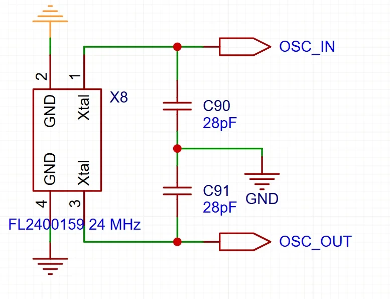

Load capacitor values I've tried (0603 package, X7R):
  • 22 pF
  • 12 pF
  • 28 pF
Same result with all three: error. Based on the load capacitance formula (Cext = 2×(CL − Cstray), assuming Cstray ≈ 3-5pF), 28pF should be the closest to ideal, but even that didn't work.

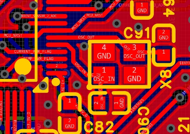

I believe I've set everything correctly on the software/config side, but the crystal either isn't oscillating at all, or HSERDY never sets within the timeout HAL waits for. Could this be a PCB layout issue (grounding, guard ring, trace length), a pin mapping issue, or a problem with the crystal/soldering itself?
I've also attached photos of the schematic and PCB design for you guys to take a look at.

Your RCC code seems to be correct. It could be a hardware issue i.e. solder joint issue for example.

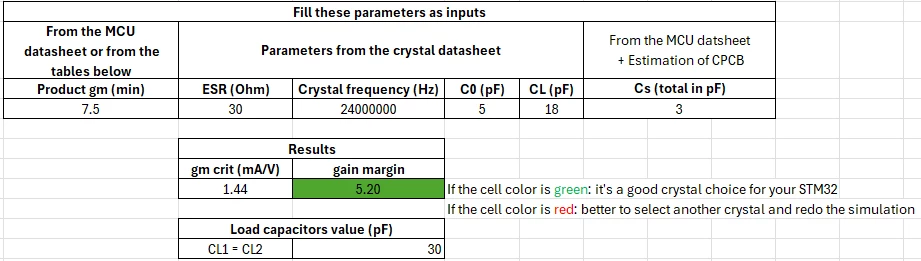

I did the exercise with the crystal STM32 compatibility calculator attached to this knowledge base article: How to select a compatible crystal and load capacitors for STM32 with layout guidelines
The crystal seems to be compatible with STM32G4 and the load capacitors are OK 28pF vs 30pF.
I suspect a PCB issue: solder joint issue or a bad crystal soldering orientation..
