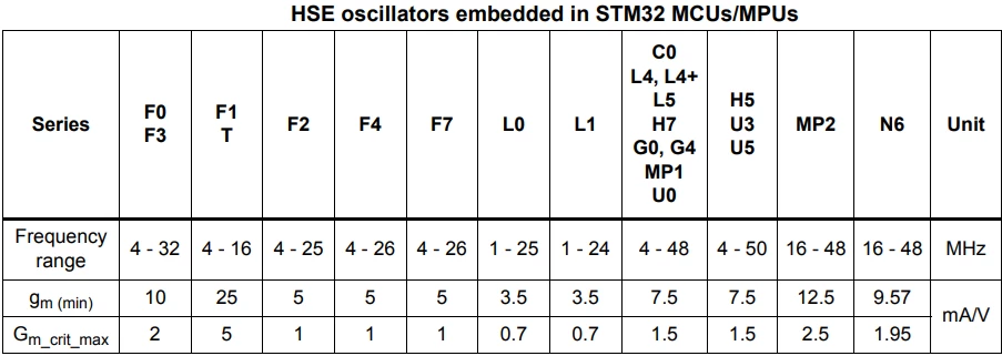

gm is the oscillator transconductance of the product. Each STM32 product has a specific value provided in its datasheet. It is also provided in the AN2867 as gm min or Gmcritmax
For HSE:
Figure 2. HSE transductance by productFigure 2. HSE transconductance by product

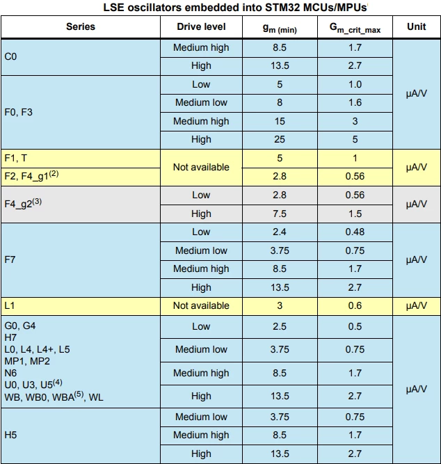

For LSE:
Figure 3. LSE transductance by productFigure 3. LSE transconductance by product

Note that the figures 2 and 3 were extracted from the AN2867 rev 23. The application note is in a continuous update each time a new STM32 MCU is released. So, please refer to that application note if you do not find your STM32 MCU in these tables.

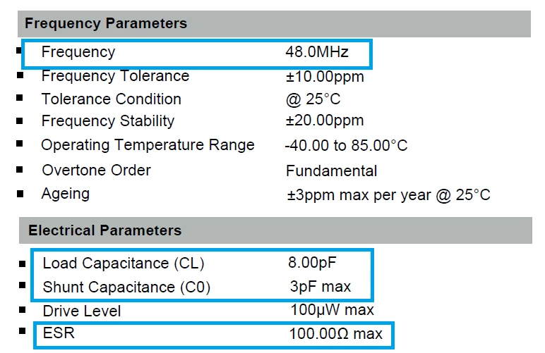

Let us take the crystal part number CX3225GA8000D0PTVCC (datasheet attached) with STM32H743 HSE.
This is the crystal specification from its datasheet:
Figure 4. A screenshot from CX3225GA8000D0PTVCC crystal datasheet

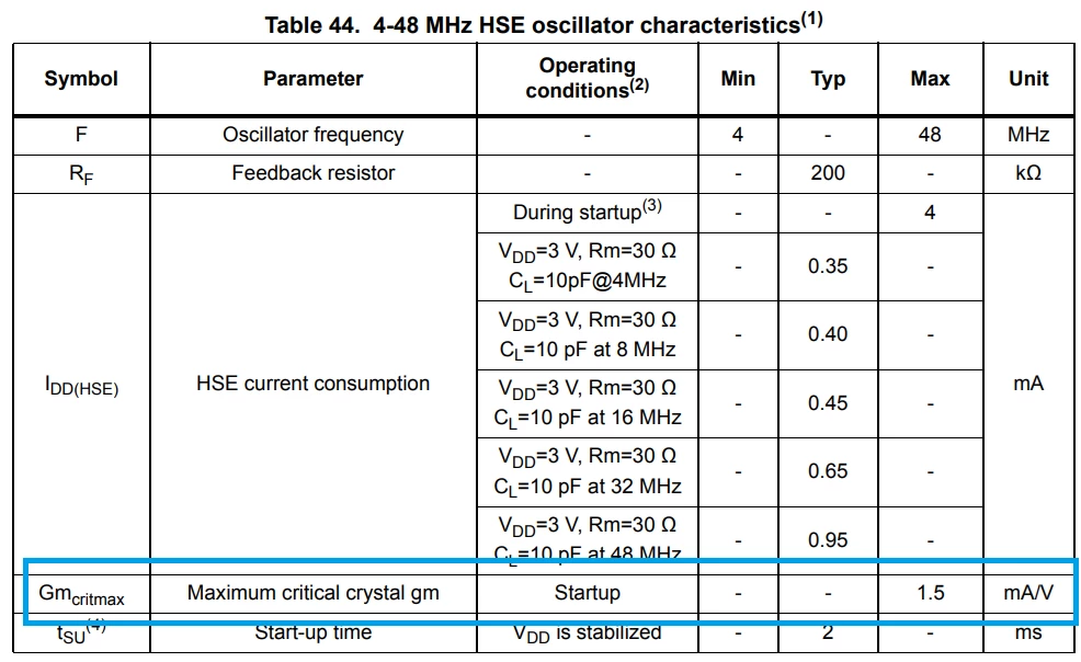

And this is the STM32H743 HSE specification from its datasheet:
Figure 5. A screenshot from STM32H743 datasheet showing Gmcritmax value
This crystal is suitable for STM32H743 MCU.

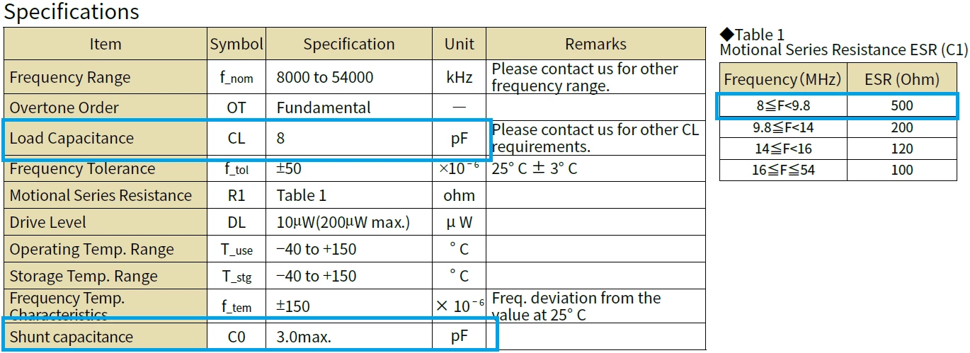

Now, let us take the crystal part number LFXTAL081620 (datasheet attached at the end of the article) for the same MCU STM32H743 HSE.
Figure 6. A screenshot from LFXTAL081620 crystal datasheet
This crystal is incompatible with the STM32H743 MCU.
Tip: According to the gain margin formula, it is better to select a lower rated frequency for the crystal to reduce the value gm crit as much as possible, thereby increasing the gain margin.

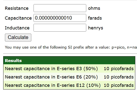

The external load capacitors will have the value:
This capacitance value is a standard value of capacitors on the market. To find capacitor standard values, please refer to this link to get the capacitors standard value.
Figure 7. Standard capacitor value in this case is 10 pF

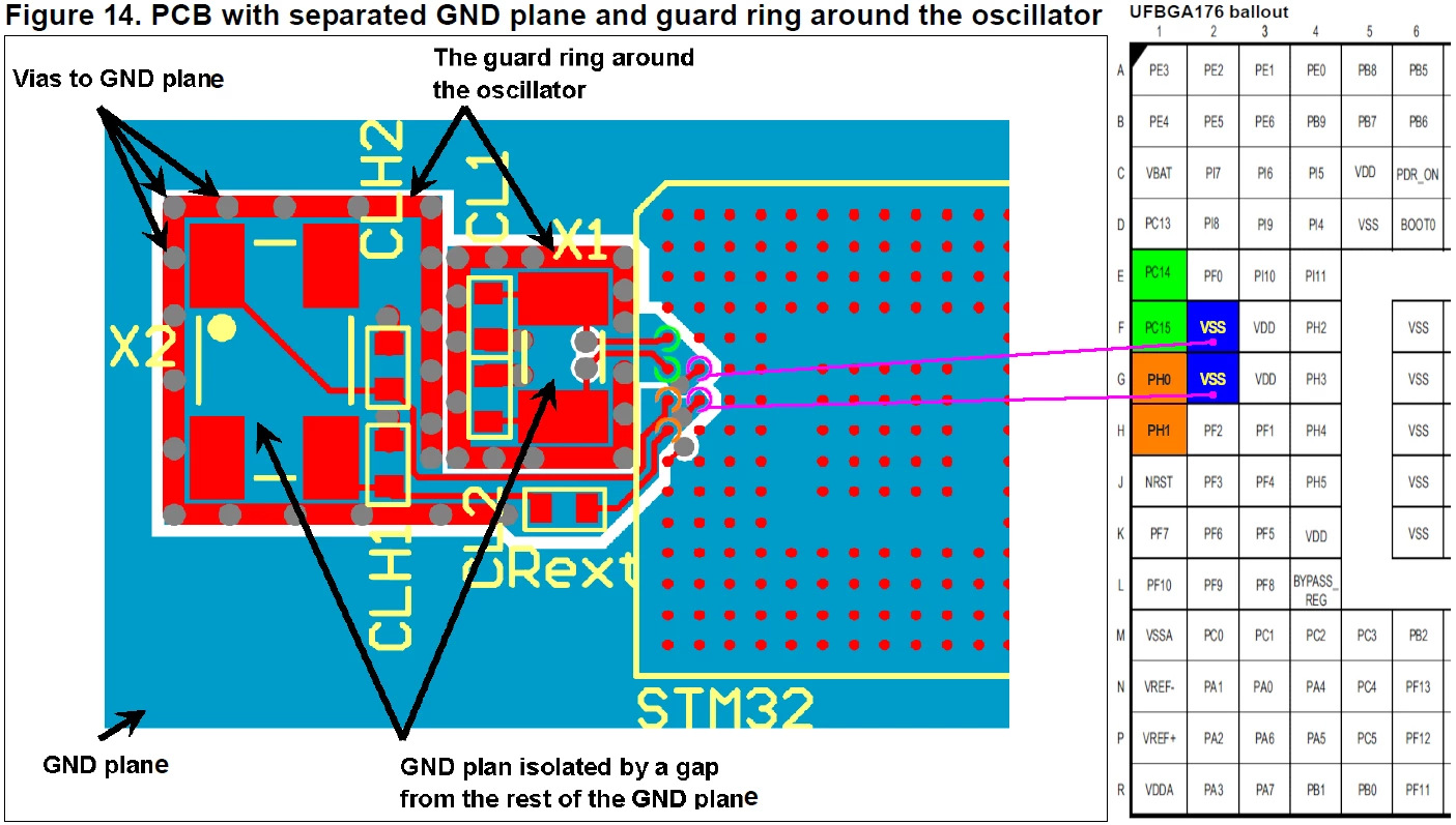

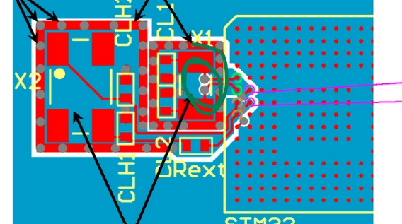

5. Layout considerations
Despite the best values for the capacitors and the crystal, stable operation over the entire voltage and temperature range can be difficult if a suitable layout has not been developed. It is therefore highly recommended to work through the important notes in AN2867, section 7, in order to achieve the desired result.
The following image shows figure 14 of AN2867 as an example, in which the pins to which the HSE and LSE crystals that are connected, are marked with green, orange and pink circles. For better clarification, the ballout from the datasheet is also shown on the right, in which the relevant pins are marked.
What is important here is the realization of the 'trough'-shaped shielding of both HSE crystal and LSE crystal. Each of the crystals has:
- its own, light blue GND 'base plate', which is separated from the other GND (white dividing line).
- An additional red GND 'wall' around the crystal and its load capacitors on its assembly layer with several vias to the respective GND 'base plate' of the crystal.
- A separate GND connection of its GND 'base plate' to the nearest VSS pin, possibly separate from the other VSS, as shown in AN2867, Figure 15
