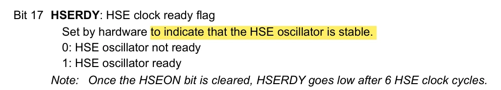

I'm not quite sure the HSERDY flag is to be expected to come up, when using HSE bypass mode.
HSERDY flag is supposed to check whether the *oscillator* has already started up and is running in a stable way; whereas with external oscillator i.e. HSE bypass, the expectation is that the oscillator *does* run unconditionally.
In the past, reports on this matter differed (albeit on varying STM32 families which indeed may behave differently), and I'm not sure there is any definitive guide from ST in this regard. If the 'G0 RM says explicitly otherwise, please correct me.

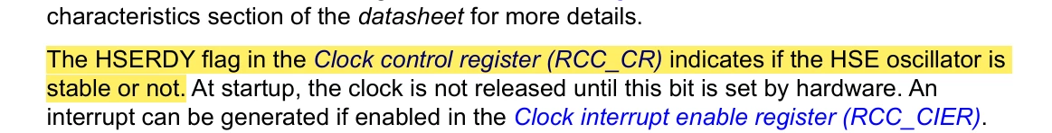

May 27, 2025
RM doesn't say anything explicitly regarding HSERDY with HSE in bypass mode, but HAL clock startup code does check HSERDY flag regardless of whether crystal or bypass is used:

And even if we assume that HSERDY isn't necessary, the fact that sometimes HSERDY is set and sometimes it doesn't seems misleading.

May 28, 2025
I think @waclawek.jan 's comments are on point here. The RM explicitly says HSERDY is the state of the oscillator. You are not using the oscillator, so HSERDY is immaterial.
The check on HSERDY by HAL is probably a longstanding bug that should be addressed. This would explain the many reports of HSERDY not getting set during startup sometimes, or otherwise intermittent behavior.

May 28, 2025
I just checked this by setting up HSE manually (without HSERDY check, so just HSEBYP, HSEON bits) and then enabling MCO to output HSE (and infinite loop after that). This results in the same behaviour: sometimes, while cycling board's power, MCO will output 8MHz signal, sometimes there is 0. Also, NRST / software reset behave exactly the same as described in the topic.
I checked a few times that when MCO has output, HSERDY flag is also set, so it seems that this flag can be used by hardware to check HSE presence even if it is configured in bypass mode.

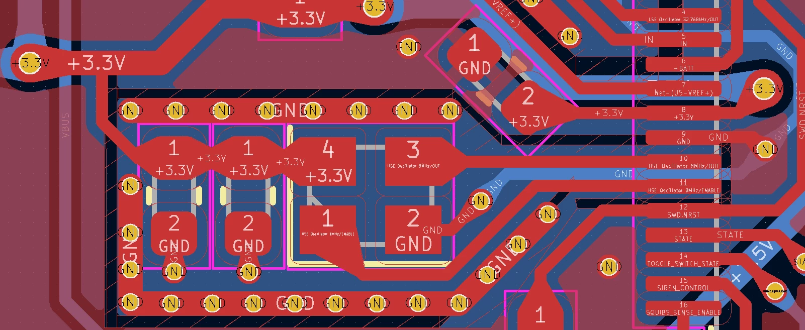

How is the oscillator connected, exactly?
May 29, 2025
2 capacitors there are 100nF and 1nF respectively.
I already tried cutting enable trace (floating enable = working oscillator) or using an external waveform generator. All approaches yield identical results.
