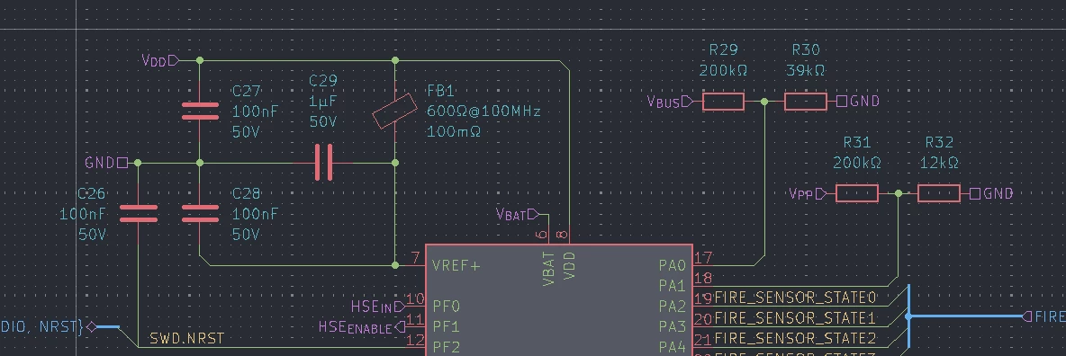

Make sure *all* VSS and VDD  (including VSSA/VDDA) pins are connected properly. Measure continuity directly at the pins (think of bad solder joints).
How is VDDA connected? And what about VBAT?
flawlessAuthor
Jun 2, 2025 7:56 AM UTC
This MCU has single VDD and VSS pins, VSS is just connected to the common ground directly. VBAT is currently floating.
We didn't tried measuring it directly at the pins, but the fact that it reproduces on multiple boards, including resoldered one with MCU from dev board, so we will check it, but we think this is not the issue.
Update: connecting VBAT to VDD make it works stable

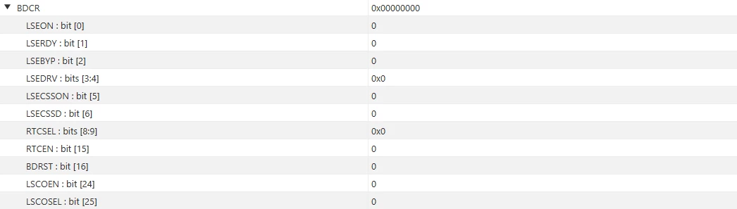

I would like to ask you to do one more experiment: in the "failed" state, i.e. when HSE does not work, can you please read out content of RCC_BDCR register and post it.
Thanks,
flawlessAuthor
Jun 2, 2025 2:25 PM UTC
It actually stays the same when HSE is ok, changing VBAT leads to the same content of BDCR

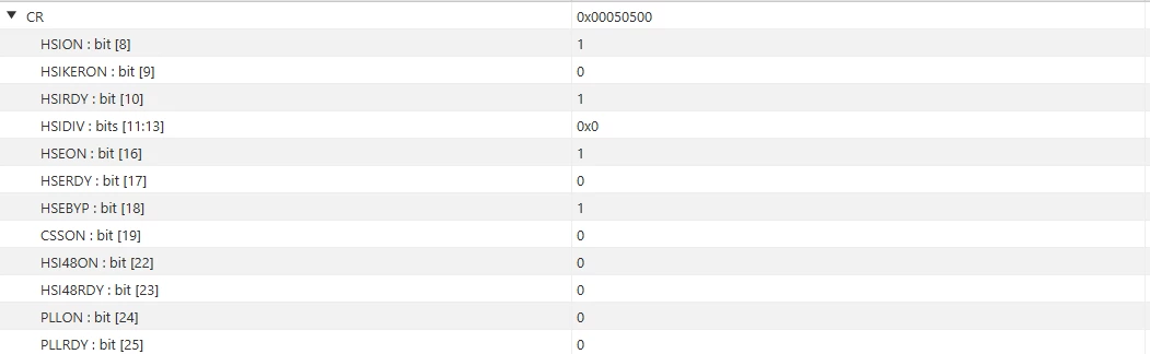

Hi everyone, just want to share a little update on what else we checked:
LSE seems not affected by this and starts normally with floating VBAT
We were unable to reproduce the original issue on F413ZH on Nucleo F413ZH desoldering the junction between VDD and VBAT and checking CR content with st-link - HSE always starting normally with floating VBAT
