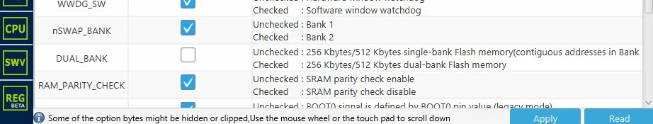

I change the "DUAL_BANK" bit.
At running time, I changed it to used a single bank flash.
Before resetting options byte, it's was as on the photo. I just enable the "DUAL_BANK" bit and after that, i'm not able to connect to the MCU.

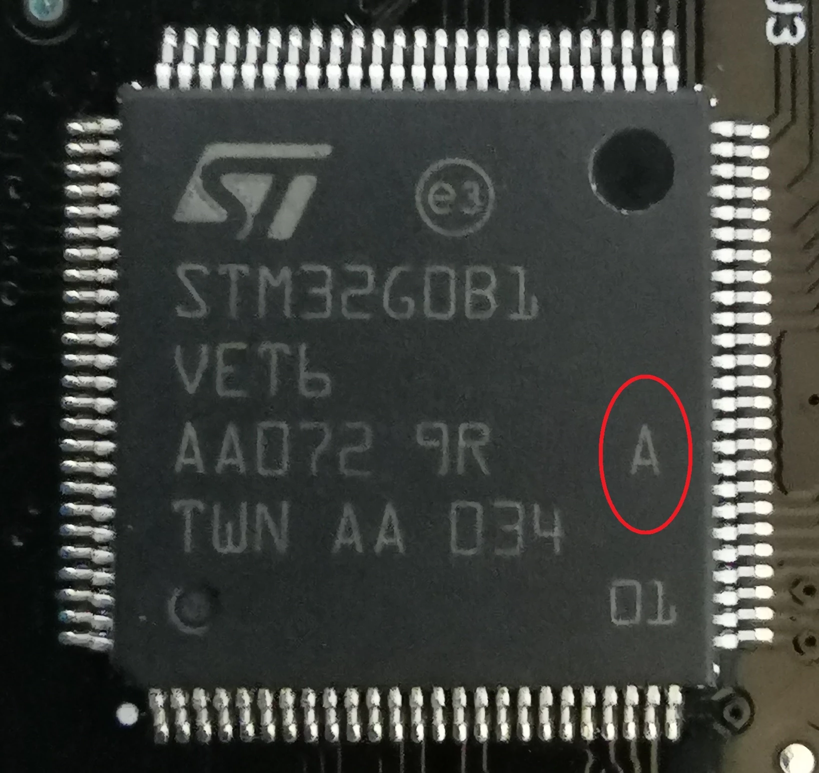

Can you confirm the REV_ID of your STM32G0B1 ?
If a rev A is used, a bad option byte programming can lock the device (see errata ES0548: 2.2.9 Device lock upon mismatch of option bytes).

If I understand right the device marking, it's a revision A.

Yes by looking your picture, I confirm that your STM32G0B1 is rev A. To be safe for the next trials I would recommend to use rev Z.
However, using STM32CubeProgrammer to program the option byte values won't prevent you against bad programming when an unwanted glitch on VDD or Reset appears. For example it can be due to low battery voltage, bad debug/reset wire connection ...
