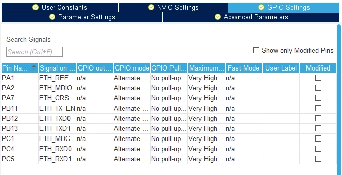

We need more details on your configuration to answer your question, as it could be related to the HW or software configuration (PHY, Clock etc ..)
Check the Pin assignment for Ethernet as it could be different from the one selected by default with CubeMX.

The pin assigment is correct as the default with CubeMX.

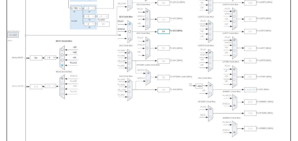

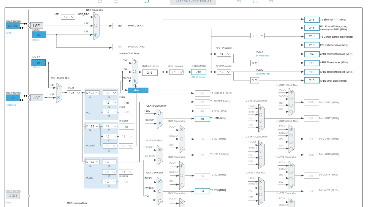

I'm using STM32CubeF7 v1.17.0 (last released version) I have a project working correctly with touchgfx just I want implement ethernet communication to this project.
Here is my Clock Configuration

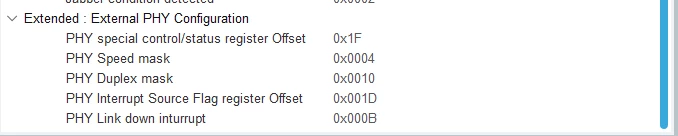

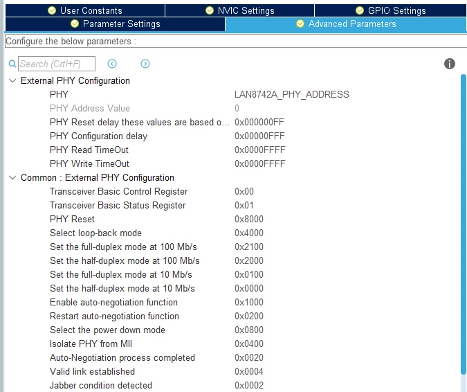

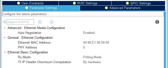

And my PHY
