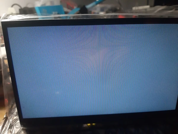

new ver with strange vertical line
www.audiodesignguide.com/sw1/stm32F429BI-test2%20%282%29.zip
hltdc.Instance = LTDC;
hltdc.Init.HSPolarity = LTDC_HSPOLARITY_AL;
hltdc.Init.VSPolarity = LTDC_VSPOLARITY_AL;
hltdc.Init.DEPolarity = LTDC_DEPOLARITY_AL;
hltdc.Init.PCPolarity = LTDC_PCPOLARITY_IPC;
hltdc.Init.HorizontalSync = 1;   ?
hltdc.Init.VerticalSync = 1;   ?
hltdc.Init.AccumulatedHBP = 76;   ?
hltdc.Init.AccumulatedVBP = 40;  -> see vertical line and with 23 no output
hltdc.Init.AccumulatedActiveW = 880;   ?
hltdc.Init.AccumulatedActiveH = 520;   ?
hltdc.Init.TotalWidth = 1080;   ?
hltdc.Init.TotalHeigh = 542;   ?

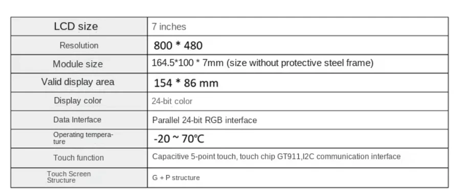

What's the Make/Model of Screen?
What's the Resolution of the Screen?

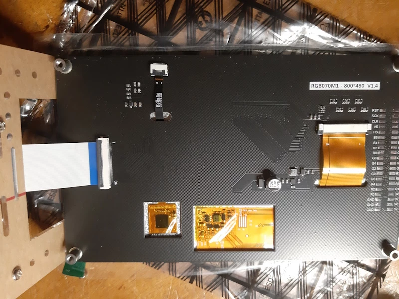

Can you provide a picture of the back showing the controller or part#, large, clear and in-focus.
Is there a Data Sheet for the Screen?
Line totals are a combination of sync, front and back porches, and the active portion (ie visible pixels), count's in pixels. Think Preamble, Content, Postamble

Until now I see only a blue screen
/* ARGB8888 colors definitions */
#define LCD_COLOR_ARGB8888_BLUE 0xFF0000FFUL
#define LCD_COLOR_ARGB8888_GREEN 0xFF00FF00UL
#define LCD_COLOR_ARGB8888_RED 0xFFFF0000UL
BSP_LCD_Clear(LCD_COLOR_ARGB8888_GREEN);
HAL_Delay(1000);
BSP_LCD_Clear(LCD_COLOR_ARGB8888_RED);

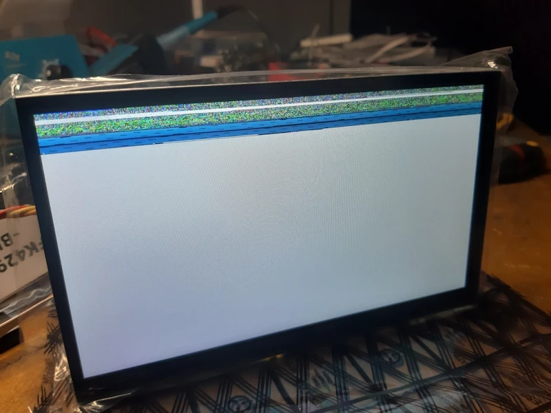

if (HAL_LTDC_Init(&hltdc) != HAL_OK)
Error_Handler();
pLayerCfg.WindowX0 = 0;
pLayerCfg.WindowX1 = 799;
pLayerCfg.WindowY0 = 0;
pLayerCfg.WindowY1 = 479;
pLayerCfg.PixelFormat = LTDC_PIXEL_FORMAT_ARGB8888;
pLayerCfg.Alpha = 255;
pLayerCfg.Alpha0 = 0;
pLayerCfg.BlendingFactor1 = LTDC_BLENDING_FACTOR1_CA;
pLayerCfg.BlendingFactor2 = LTDC_BLENDING_FACTOR2_CA;
pLayerCfg.FBStartAdress = 0x08000000 ; // x 0xD0000000
pLayerCfg.ImageWidth = 800;
pLayerCfg.ImageHeight = 480;
pLayerCfg.Backcolor.Blue = 0;
pLayerCfg.Backcolor.Green = 0;
pLayerCfg.Backcolor.Red = 0;

Ok, so that's indicative that the LTDC is working, but the SDRAM at 0xD0000000 is NOT
Check the SDRAM / Hard Fault situation, you complained that writing the Frame Buffer "Hung" the board, probably Hard Faulted. Establish that is the case. Then make sure the SDRAM is initialized properly, and you can zero fill the Frame Buffer. That should be BLACK. Of fill with 0xFFFFFFFF which should be WHITE

with 0xFFFFFFFF the same result of 0x00000000
Tesla DeLorean
Guru
Apr 24, 2024 9:08 PM UTC
?? Being Blue or Hanging?
Ciuffoly
CiuffolyAuthor
Senior
Apr 24, 2024 9:33 PM UTC
with 0xFFFFFFFF and with  0x00000000  I see the strange image post before
